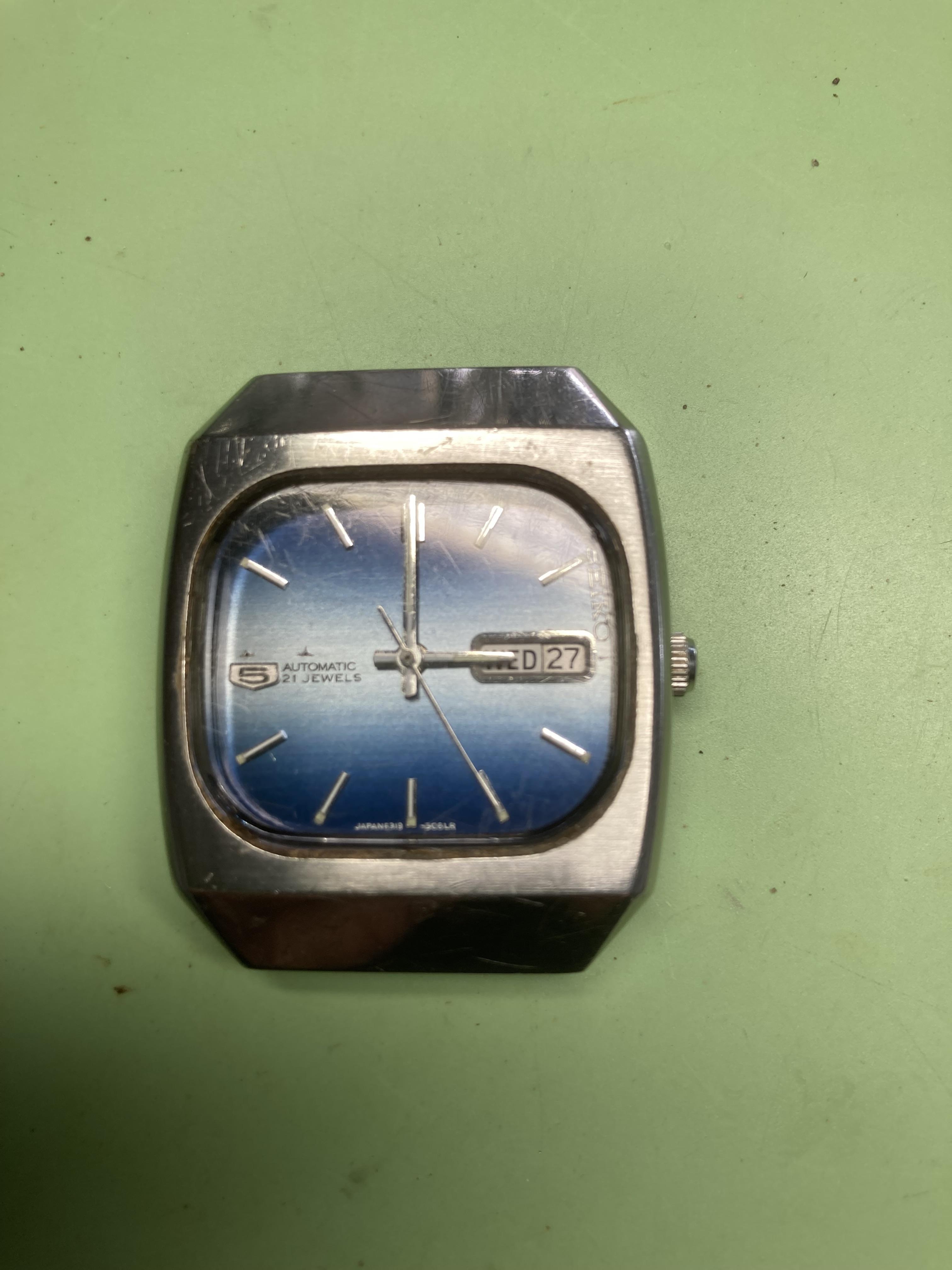

Hello watchlovers, I bought this nice vintage Seiko to restore. But now I have problems removing the caseback. Does anyone know how to remove it? Thank you all in advance. With kind regards, Hans.
In third image, you have shown the two slots facing us, push on those, this will unlock the back plate which( the back plate) houses the movement. the bracelet covers the slots.

Hello Nucejoe, yes that's right. I managed to open it. Thank you.
But then I removed the crystal. But how can I get out the movement? Is this a split stem(male and female part)?

Hello Nucejoe, thank you very very much. Now I can go on. It's very nice to contact people with a lot of knowledge on watches. With kind regards, Hans
