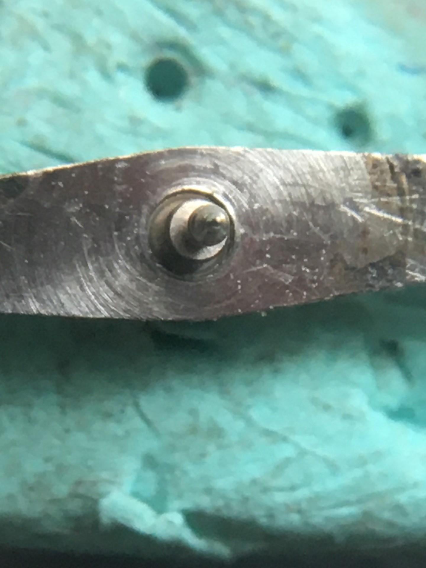

Hi guys,
Before I drive the balance home onto the staff i'd like to make sure i have a correct fit.  I laid the balance wheel on both the old and new staff and on both there is a gap between the staff hub and the balance; i knocked out the old balance.  is there supposed to be a gap or should the balance be resting on the staff hub at this stage; to next be riveted into place?  Thanks for any input.  Arron.
Always nice if we had details like which watch which staff?
Then know that is not correct. The balance wheel should fit all the way down to the hub Otherwise if you have to pound it into place you're going to to start the balance hole or conceivably distort the whole arm. So it's supposed to drop in the place with minimal just pushing it down it should be up as high as this is.
i had every intention to include the watch specs but then forgot so thanks for the reminder. Waltham serial 4783027; model 1888 16s 7j.
if the balance is supposed to sit on the staff hub without force, then maybe i distorted the balance hole when driving out the staff.  is there a fix to get the balance seated without force, like maybe using a round or triangular broach; i have those.  here's another pic from the top of the balance.

Verifying the issue is the first step in rectifying the issue. How much can you magnify the balance wheel hole to check for distortion?
thanks guys.  i checked the hole under magnification and it doesn't look distorted to my eyes.  i used a stake to gently put the balance on to where it sticks to the (old) staff but isn't all the way down; i'm fearful to drive it down until i figure out what the best course of action is.
the staff i ordered is the 2844.  i had previously ordered one from ofrei, and posted about it, but the hub was a different thickness so it couldn't be used.  the current one seems to be the right one; ordered from Daves.
at this stage i think i either go forward with staking the balance onto the new staff (and hope it goes on without distorting the balance) or i could use my lathe for the first time and try to skim off just a bit of the circumference of the staff (after practicing on the old staff).  Thoughts?

I am very happy and relieved to report that I was able to fit the balance onto the new staff.  I used a flat stake with a hole and used just moderate hand pressure.  Now on to the rivet.  Thanks guys for all the encouragement.
I attempted to make the rivet.  I'm not sure what it is supposed to look like after riveting.  I tapped with the domed punch first and then the flat punch.  the staff does seem to be gripping the balance when i try to hold the staff with the tweezers and rotate the balance with my finger. What do you think?
Usually what you do is first with a flat punch you just make sure the balance is down tight on the staff then with a series of rounded nose punches starting from the center and pushing the rivet out. But it all depends upon the particular staff some you might not have to have so many punches it just depends on the particular staff then once it's down nice and tight you think it's tight then you follow up with a flat punch to make sure the rivet is down flat
then how tight is tight? Tweezers I don't think you do it when I was in school we grab the staff for the pin vice and we put something on the other end like a little piece your sticky clay or will piece of pith wood because you don't want to damage the pivots but something on the other side so you can see if you rotate So you hold the balance wheel in one handy rotate the pin vice and it rotates is not tight enough.
Then if you're concerned about holding to type with the pin vice start with a balance wheel you don't care about grab it tight and see what happens
then you go onto the next phase of making sure the balance wheel is still flash and round typically on a bimetallic balance wheels it will get out of both of those especially depending upon how aggressive you were taking the staff out.

I tried using the pin vise as you suggested and it seems tight, so i'll consider the operation a success.  thanks for the idea and for the catalogs link.  i have a couple of them but there are many more that i've never seen.
