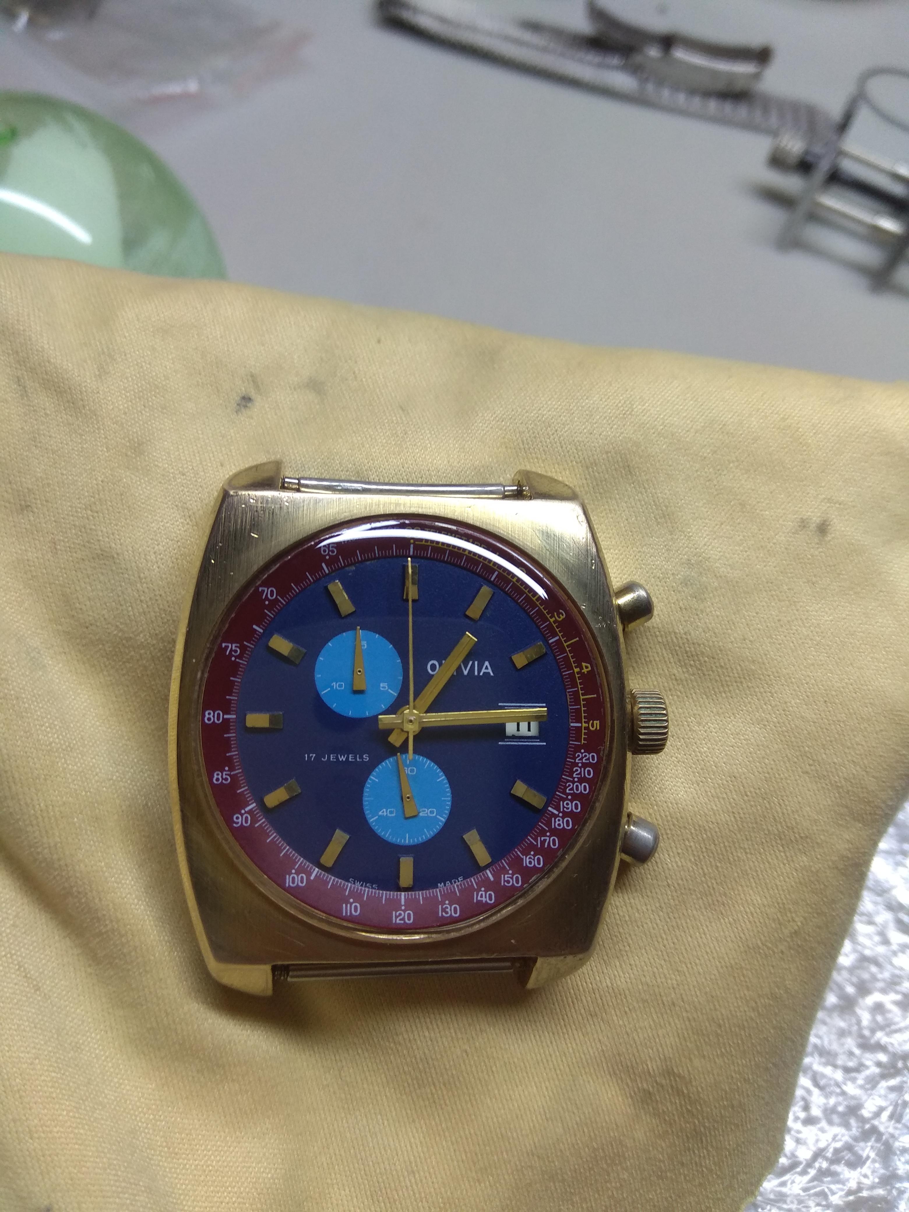

Thanks Delroyb for this very helpful walkthru.
My Sears plastic cased "Easy Rider" chronograph is finally running properly after 10 years in the projects bin.
On 6/28/2019 at 12:47 PM, Amateur said:
Hi Delroyb
Any recollection and advise on how to put that Chrono pusher spring back?
Thank you I appreciate it.
J.B
Hi J.B.
You probably worked this out yourself already but what I did was not to set both ends of the spring right away.
Instead, I set one end, then fitted the bridge over the chrono levers, tightening the screws down halfway.
I then set the other end of the spring through the cut-out in the bridge while keeping the bridge in place by pressing down lightly on it with my fingers.
Once the spring was in place, I tightened the bridge down fully.
I managed to get it done without a hitch, but in the event the spring does slip off the lever, it will be held captive under the bridge.
