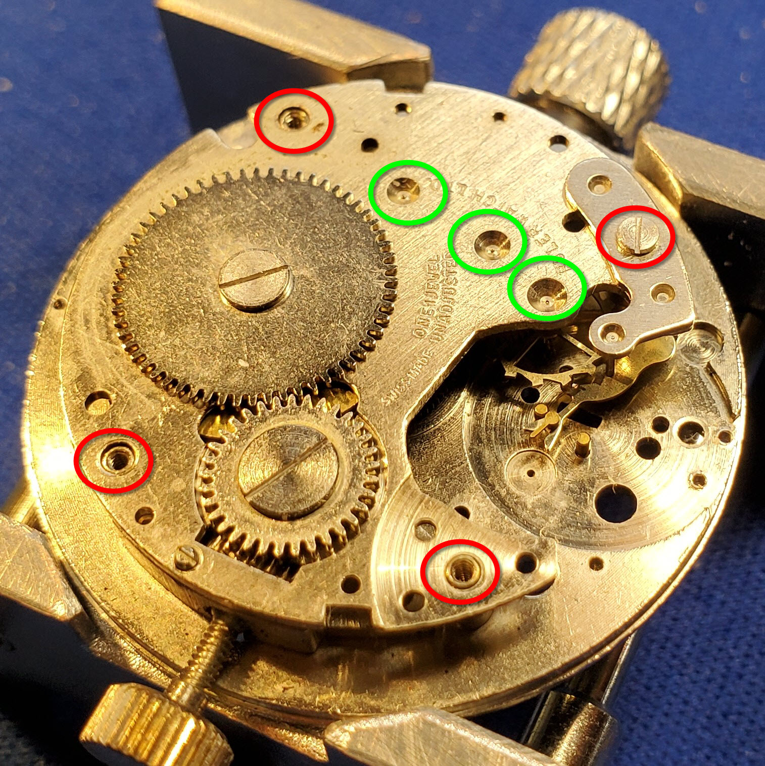

Installing Train Wheel Bridge BFG 866 (1 Jewel) Movement

Hi one assumes by the addition of the pictures you have the technical sheet for this watch. As mentioned by @HectorLooi center wheel canon pinion .take it down again and install only the parts required to set the hacking and turn the hands checking at each stage for correct operation.
