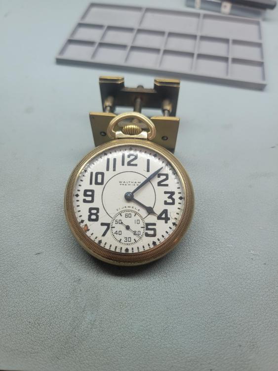

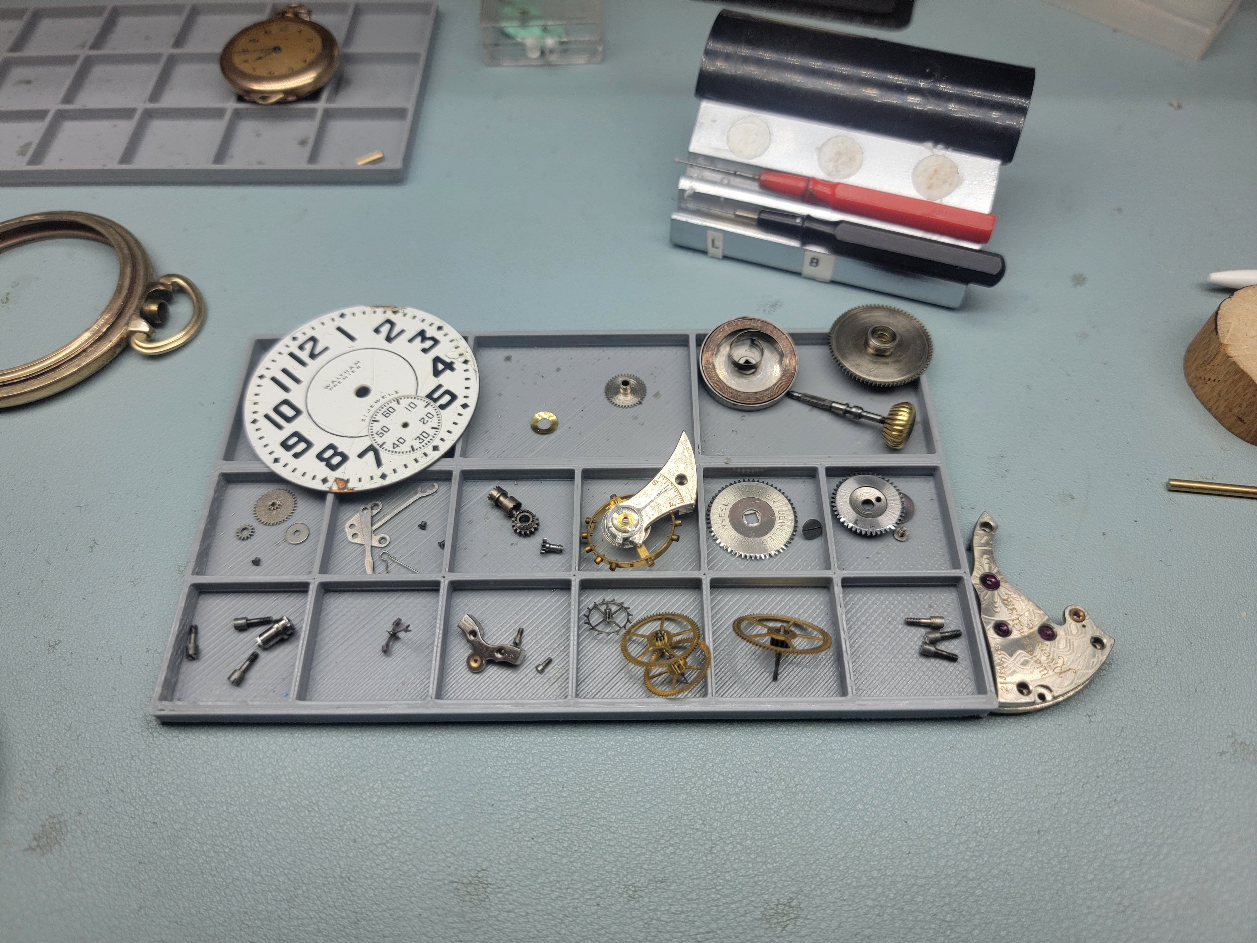

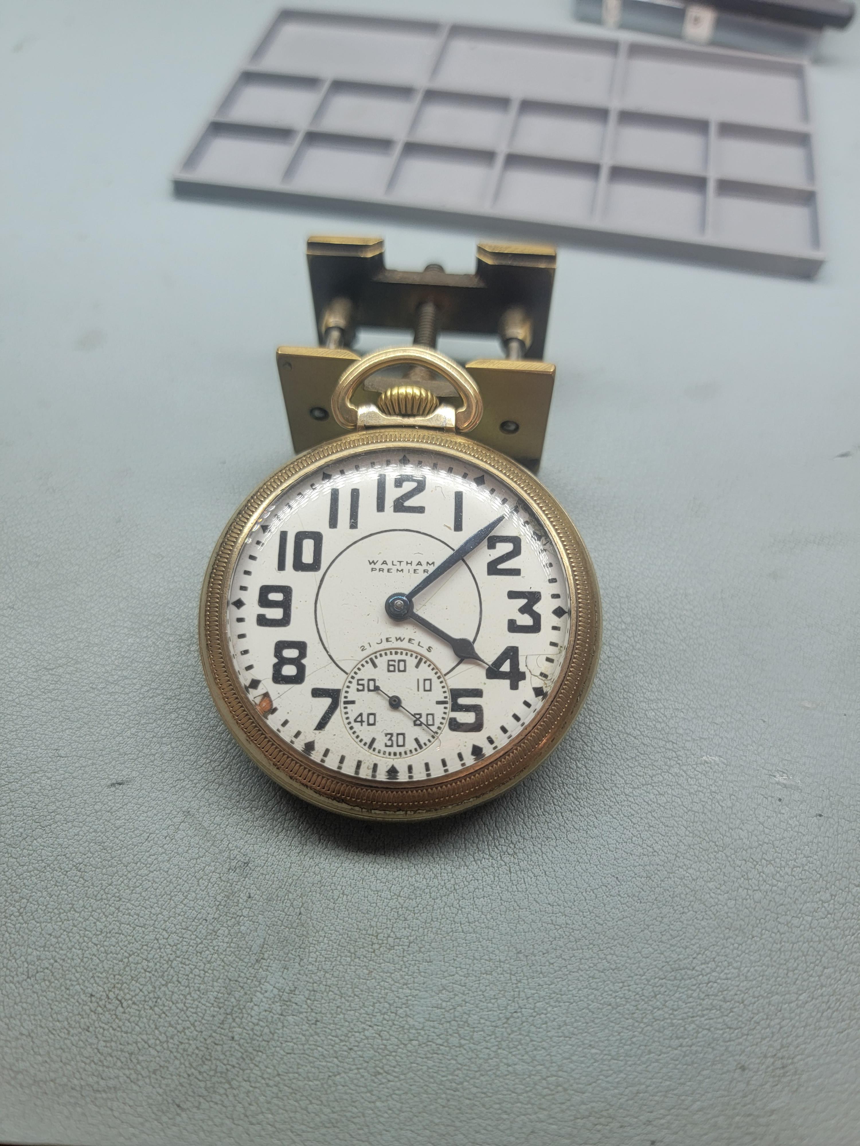

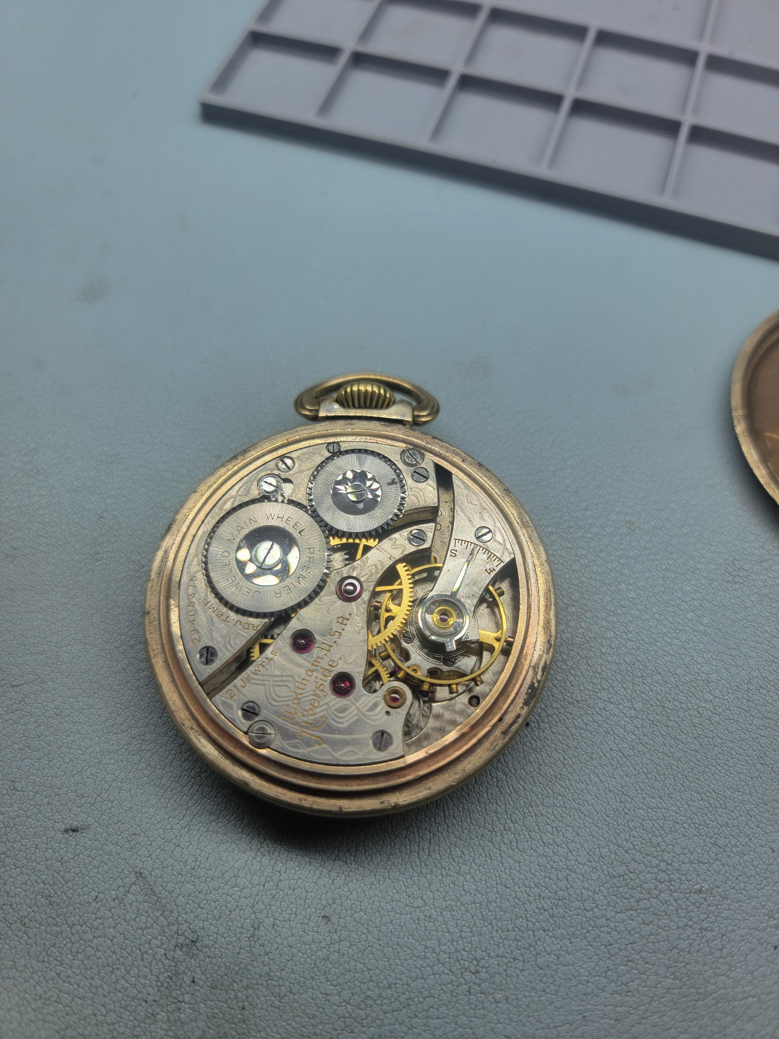

Nothing spectacular here.  I serviced this one today.  The only extra I did was to put the balance on the Jacot and polished the pivots.  Everything else was standard fare.
Decent performance:
DU +6 231
DD +1 240
PU +2 206
PD -5 220
Prolly not that great for those addicted to amplitude porn.  I did not replace the mainspring.
