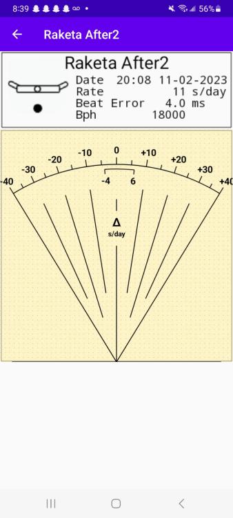

Hey guys! Complete amateur here, working on my first project, a Raketa Perpetual Calendar with the Raketa 2628.H movement.
As per the reading from my timegrapher phone app (yes, please scold me, a Weishi 1000 is at the top of my list to purchase next) the rate is +11 seconds, which is acceptable to me. What isn't acceptable is the beat error, which is an abysmal 4.0ms. How would I go about curing this?
