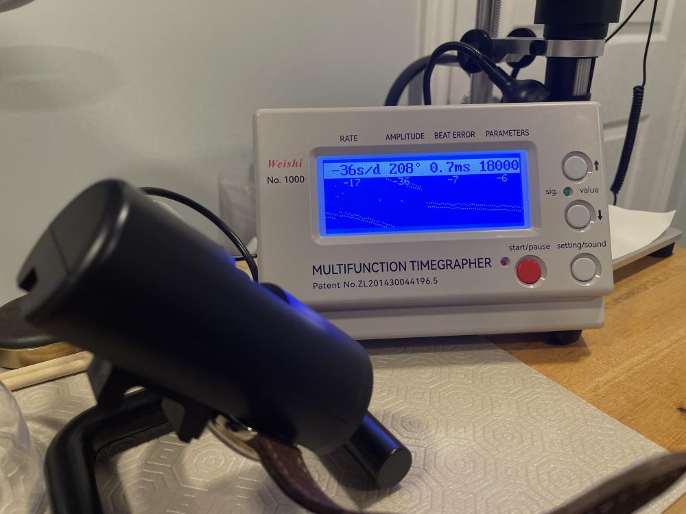

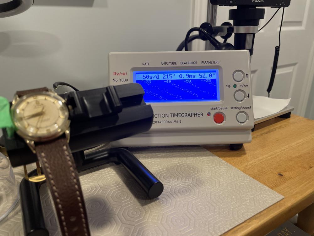

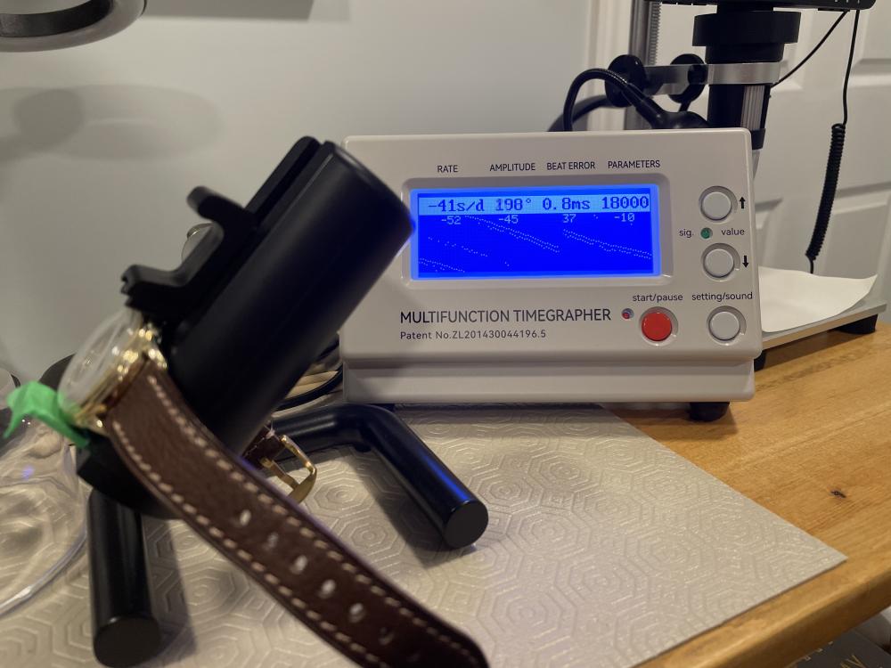

On the timegrapher I got good results in flat positions, face up and down, but performance suffered when the case was once its side, if that makes sense. I don't know what that means or how I could improve that, but as long as the watch keeps good time for a day I am happy as I change my watch every day.
In vertical positions, more surface area of the pivots rid on the jewels,therefore more friction and lower amplitude.
Adjustments to decrease positional variations start with that of the end shake on balance staff, furthure adjustments is generally made if the watch is a good grade one and by experienced watchmakers.
Show us the difference in amplitude to see of it is acceptable.

Thanks for your response. Here are some photos of readings in different positions. I focused on the screen but you can still see the watch position in the foreground. I adjusted things when assembling when the movement was flat and get good results here. I did not know how to adjust for beat error on this movement.
I am quite happy actually that none of the positions lose more than a minute. Today is the first full day I have worn the watch and I can’t see it losing sun time so far. Maybe my wrist is mostly flat during the day (I do work at a desk/computer).
