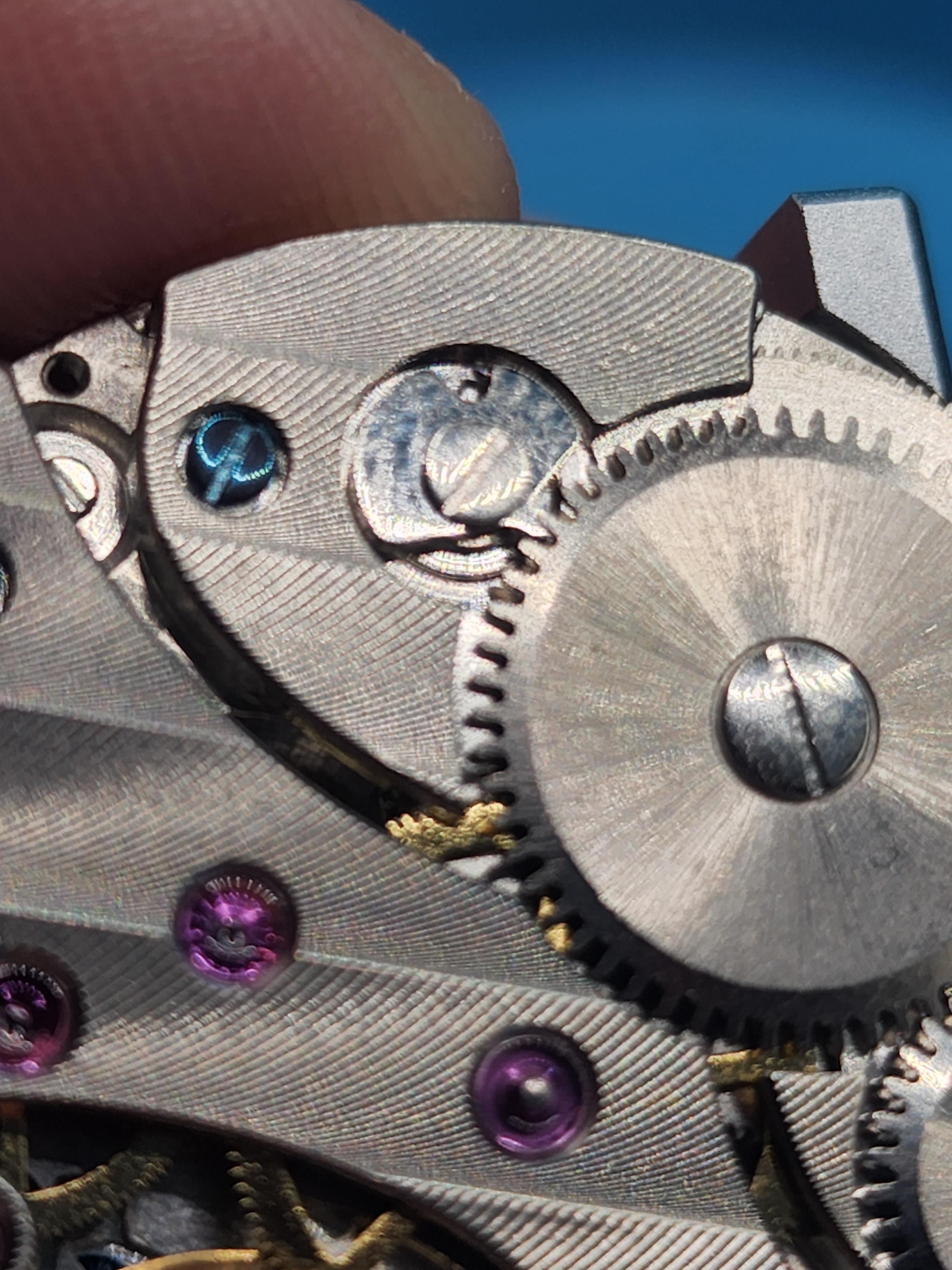

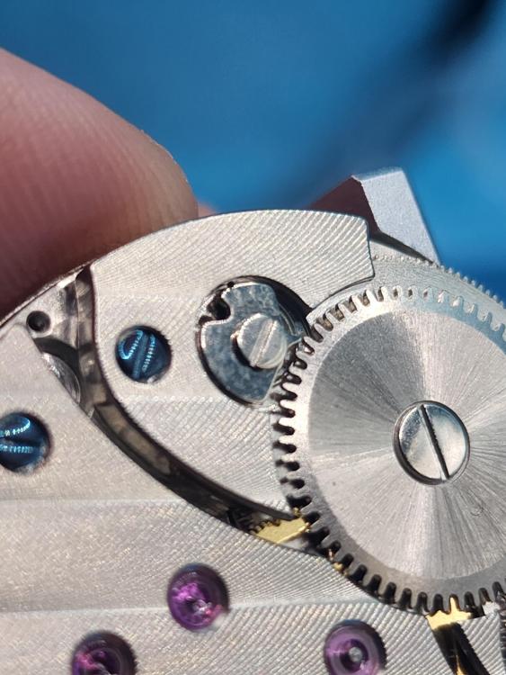

I cant get the click spring installed correctly on my 6497.  The spring wedges between the click and the bridge so it doesnt engage.  I know its something simple but im stumped.
This is watch #2, was able to disassemble and reassemble this in a reasonable amount of time and the balance even still works.  The click is my last hangup lol
Just looked at a book.  I think i just need to tighten that spring and make it tighter.

I hope Mark doesn't mind me clipping his level 2 repair course video to help a friend in the biz (https://www.watchfix.com/).  I've attached an image of the click spring placement and another of the click in place. Hope this helps.
Edited by HLPayne
Thank you so much, HLPayne!  That was a big help.   I got that thing working and wound it up.  No idea how well it's doing but the wheels are going round and round, and that's enough for today.
