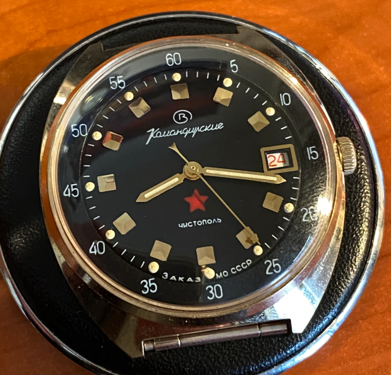

I am repairing a Vostok with a painted bezel (I think that is what it is called). The painted part is not separate from the case so any cleaning, polishing, or re-plating has the possibility of damaging it further. Any advice on working around this? My only thoughts are to try some durable table that I can stick on the paint and cut off the excess so as to mask it. I'm afraid this might damage it as well though.
Does this ring sit under the watch crystal?
I've not seen this Vostok design before. I've only worked on a couple if Amphibias and Komandirskies. Could you post a photo of the watch before disassembly?

@HectorLooiYes, the chapter ring sits under the crystal. Here is a gold version of the same.image.thumb.png.bb62e95c21d42cc4f60e336c70ba687e.png

Thanks for the advice! I don't have any plans on restoring the purple/blue paint and I am of the same mind in that I would rather not attempt to repaint this chapter ring at risk of drawing attention to it. The rest of the case is in pretty sorry shape. Lots off brass showing, very dirty, and very scratched up. I can clean it by hand with some peg wood but what can be done about the rubbed off plating without affecting the chapter rings? If there is no hope of polishing or re-plating, that's fine, but I would like to explore the options.
The chapter ring on the watch in the picture is the hash, minute marks around the dial. The 5 through 60 are also minute marks so they form part of the chapter ring, but on a separate ring, so that's why I called it a bezel, thinking it was an internal bezel. But, I think the definition of a bezel is one that is on a different scale than the chapter ring. For example, a Tachymeter ring is not a chapter ring. It doesn't rotate and sometimes is internal but also external. I would call that a bezel. A diver countdown ring is not a chapter ring, even though it is a minute scale. But it is rotatable, which makes it separate from the chapter ring. A minute marker that does not rotate I think should be called a chapter ring, so, I agree with Hector.
Both of these examples look nice and I hope you enjoy getting them looking as good as you can. Good luck!
Re-plating involves putting the case through a diluted acid bath, then through a nickel / chrome bath to electroplate it. Covering that chapter ring to prevent liquid ingress during this process will be a challenge. Maybe you lucky and you can put the glass back and case back. Find a way to seal the stem tube. Then you can plate the case, but understand you’ll have to spend time ensuring there’s no leaks so fluids can’t get to the chapter ring. I’ve done some DIY nickel plating so it’s something you can experiment with at home. Alternatively there’s a “wipe on” plating process you can try at home that doesn’t involve immersion in liquids, but basically dabbing an anode in plating solution and wiping it over the surface to be plated. I’ve never tried this method but I’ve seen is being done with ok results. Those are the only possible solutions I can think of

There are some special masks that you paint over the part to protect it during the electroplating process and then remove them using a solvent, I'm not sure if you can use them in this case but it's worth having a look at that, alternatevly I'v seen a guy covering a part with paraffin wax and ptrolium jelly but I think that's just video magic because plating solutions can get hot and melt the wax and the jelly away.
