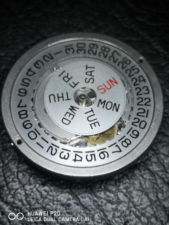

Finally got his watch apart. Now i am stuck on how to get gthe right date with the right day.I think i have put it back together correctly. But the day and date dont want to stay correct.(i mean i get the right day but the date for that day is wrong). And i cannot see a way of doing it using the crown and stem. The stem only pulls out once and that moves the hands  and every 24 hours the date and day.
Its a certina 25-652 movement.
Any suggestions?
cheers
gary
Date also changes through the crown in time set position, move the hands past 24hr , then turn anticlock to 22hr finally turn clockwise past 24hr, to change date .
