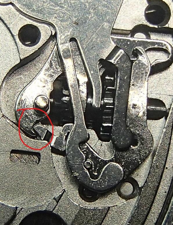

The issue your facing is that the end of the yoke ( previously shown)  which is to enter the groove  (on mainplate)
Before buying another yoke, do this test: push the yoke end with pegwood so it enters the groove , it should and will then move towards the setting wheel easy by action of winding stem.
Ok, I think I understand what your saying, though “ the groove ( on mainplate)” is somewhat confusing. I suspect you mean the “ notch in the connector lever”.
The notch thats cut on the mainplate is for the corrector to travel  left-right on, A hollow space underneath the notch  is what I am calling the groove, yoke end is to pass through this hollow space.

Because of the bend,  this end hits the setting wheel  so can not reach its final destination.
Find the groove underneath the notch, which the end of the yoke is to pass through first.

Well, I am very, very pleased to report that I have fixed the problem!
The yoke was indeed bent, (Right where you said it was Kalanag) and I was able to bend it back into the correct position and now the date corrector works perfectly ! (and all other positions now work smoothly too).
I must say that I am flabbergasted at how week the metal is, it is SO easy to bend this part.
I now know that I bent the yoke while trying to insert the stem with it misaligned to the square hole in the crown wheel. This is a VERY fragile part and it is an understatement that one must be extremely gentle when inserting the stem.

 This is a culprit with the yoke in ETA keyless. it bends, usually in the event of an impact ( shock) to winding crown.   A bit of filing and polishing the very end of the yoke plus some grease would do good, as said its thin so not much material is there to file and polish.
