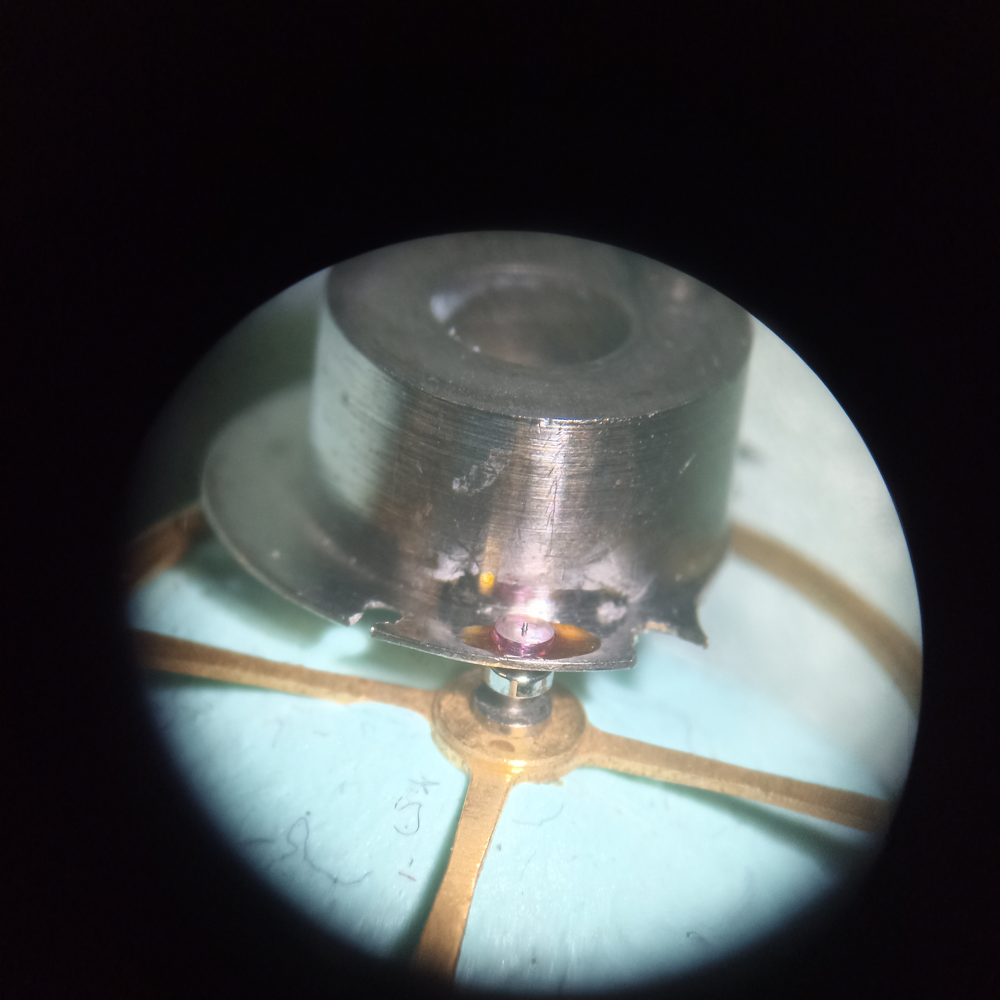

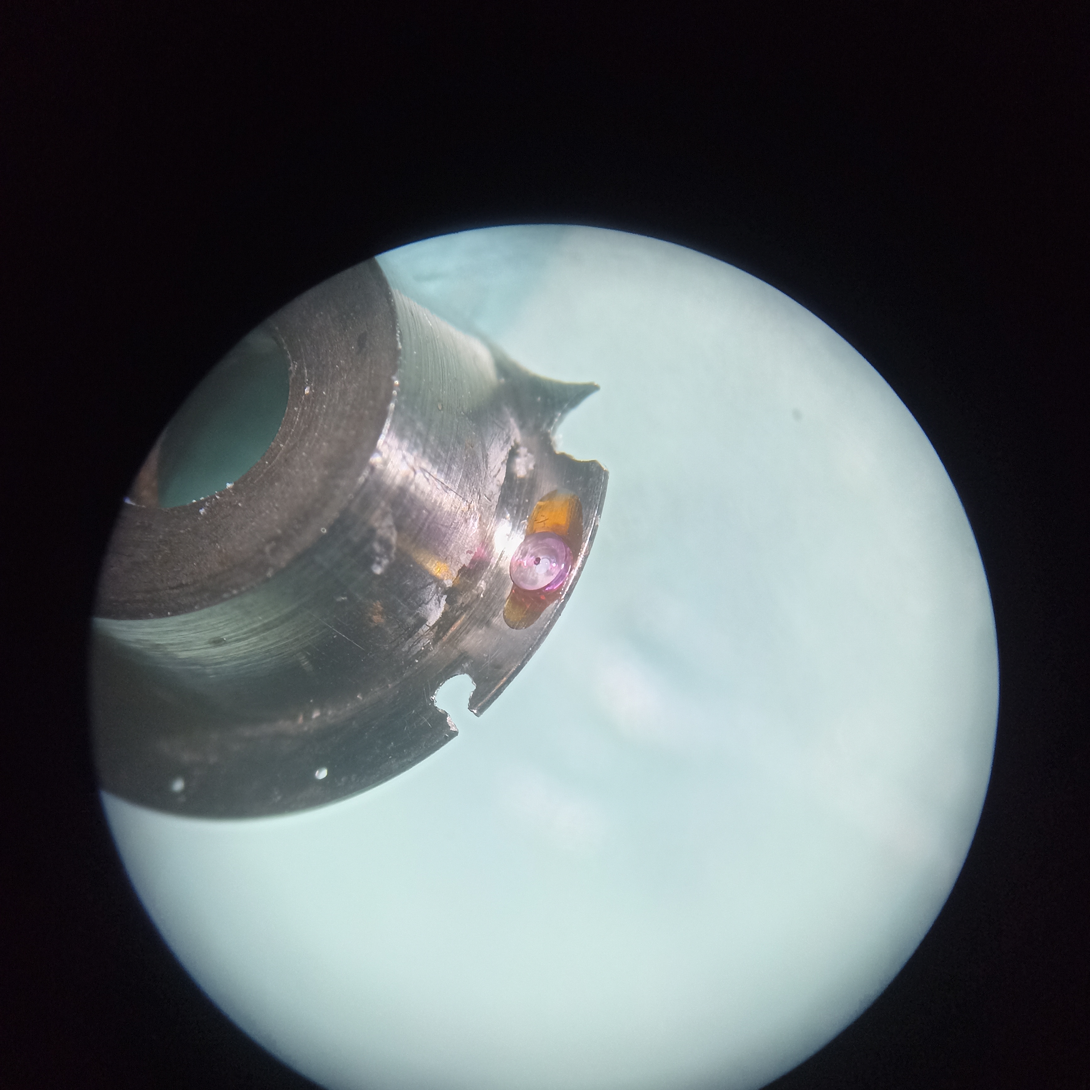

I got an idea and had to test it. I had one bad lantern so I made some experiments on jeweling it. I enlargened one hole so that it accepted the whole balance staff and then glued a jewel over the hole (Seitz flat olive with 0,08 mm hole). I used shellac since it's easy to soften if you need to adjust the jewel. Optimal solution would be to drill a hole the size of a small jewel but I didn't have the small jewel nor the drill bit. Or reamer small enough. There would also be no centering issues that way. So I did some pivot rounding for a test and it worked as supposed so upgrading these lanterns with jewels seems like an option. In a pic it looks like the jewel's not centered but it's photographed through the left ocular. Any thoughts?
