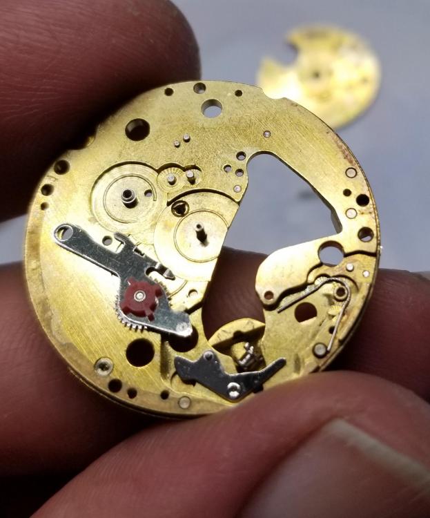

Latest Timex model 87 (1970, West Germany Electronic Durowe cal. 882). I’ve discovered two significant modes of failure on these:
The first is a weak arresting magnet for the index wheel (understandable as they are 50 years old). This allows the index wheel (I call it the ninja star...it will disappear like a ninja, too) to backtrack too far when the index lever (like a pallet fork) retracts. Essentially, the movement ticks like its running, but the second hand won’t move because the index wheel is not actually advancing.
The second is a weak capacitor in the control circuit. Again, 50 years old, so not surprising. The 220-250nf capacitor holds a small charge generated by the balance coil during its initial stroke, releasing that charge on the backstroke to drive the balance. A weak capacitor results in low amplitude, again causing the watch to tick, but not advance the index wheel or second hand. Replacing the capacitor solves this issue.
