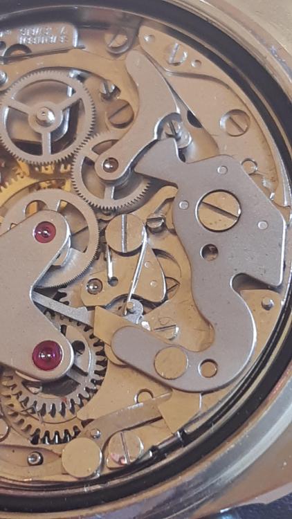

Hi
The screw is fitted on the chrono bridge plate but is loose when adjusting the sliding gear 8100. The issue is that when you start stop the pusher, the hammer 8220 rotates the screw and sliding gear wheel moves closer to the chrono wheel "needle" and gets stuck and the minute recording stops.
How can I tighten the screw? Or can these be ordered in case its worn?
