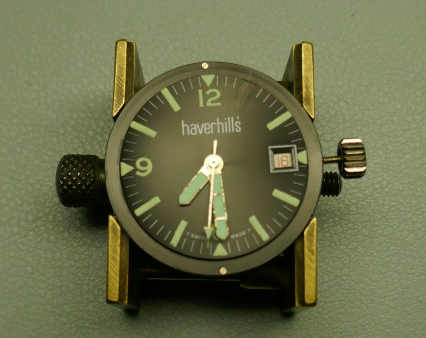

I bought this watch on Ebay.  It looked interesting and was not a lot of money, so hey...a little project to hone my skills.
When it arrived, I wound it up and did some 'tic'ing and off and on some 'toc'ing.  But the balance was clearly sluggish...struggling for the next tic or toc.
So today, in a fit of boredom, I decided to clean it.
My first image is the watch as I saw it on Ebay.

While putting the hands on and adjusting them to get a perfect calendar roll over, something hit the one o'clock lume and it popped off.
No biggie...I will glue it on.  I did this once before on another watch.  Well, no bueno.  The glue caused the lume to fracture and it was a mess.
Who needs one o'clock anyways!  Nothing happens then.  It is not a happy hour.
Here is the final result (sans case).
That's my story!
