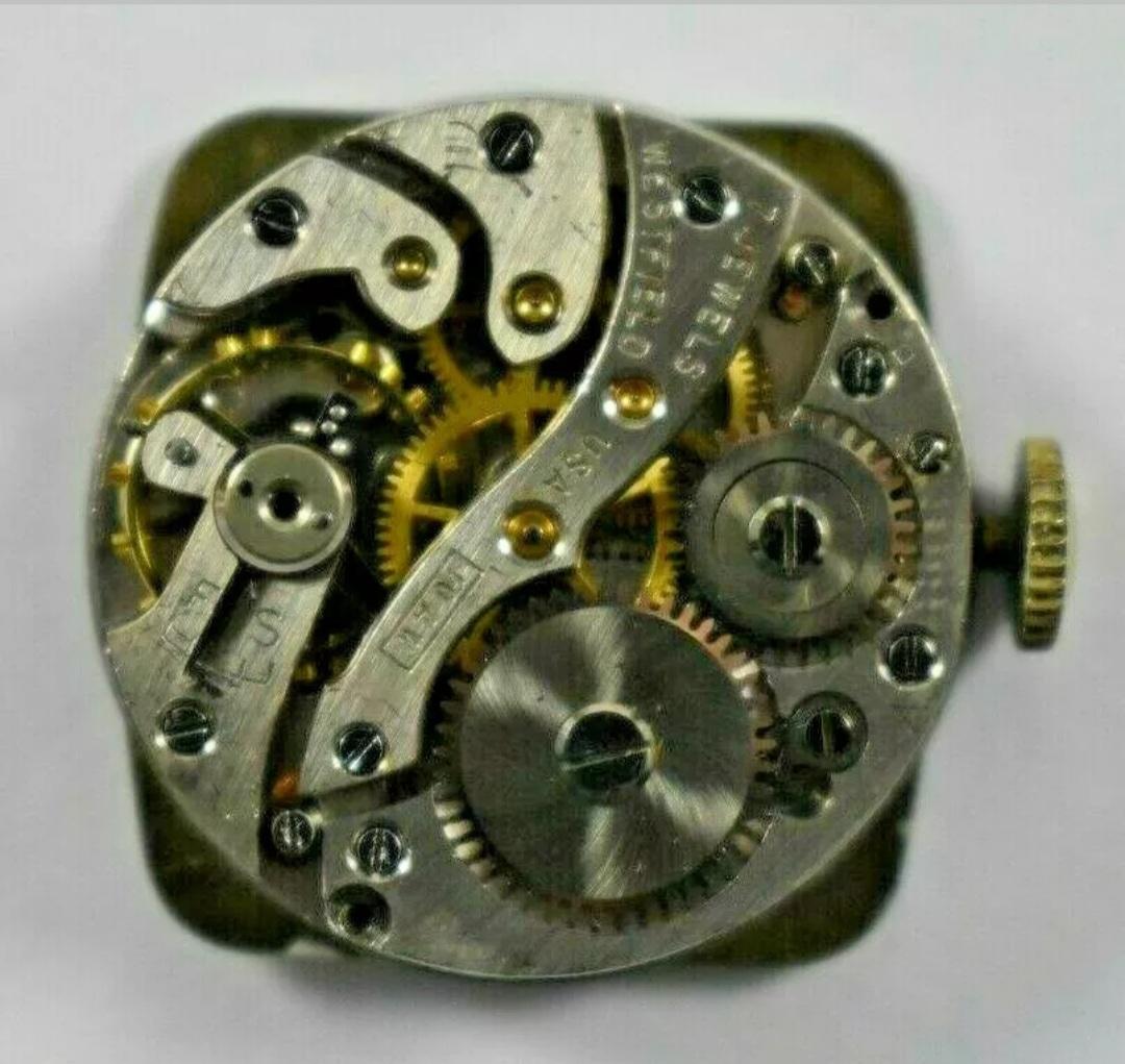

After a delay, the watch arrived. It looked thousand times better in hand than it did online, thankfully. It was fitted with a truly pristine Crystal that surely must be a recent replacement. The case doesn't seem to have any base metal showing through. I promptly opened the watch and lifted the dial and movement from the case.
The Westfield as it arrived...
A close-up of the barrel bridge showing the little crescent moon date code signifying the watch was made in 1938...

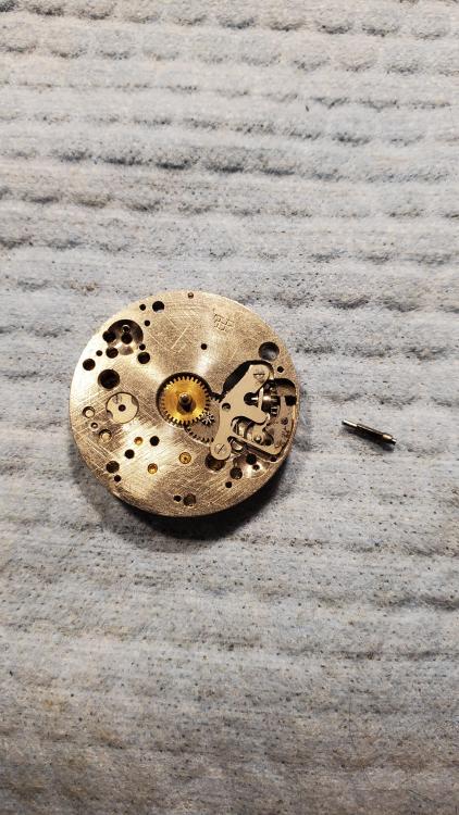

Looking closely, I found that the crown and stem weren't just missing, it was broken, snapped off at the winding pinion. I removed some of the keyless works to get at the stem remnant. After fishing the piece out, I pulled the crown and stem from the donor.
Winding stem switcheroo...
