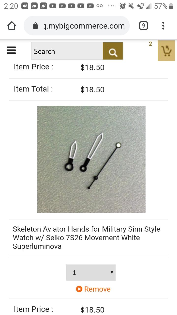

Hi my name is Daniel I'm in the USA. This is the second time I ask for help on this forum. I'm new to forums and in the last one I didn't introduce myself. I apologize for that.  I have a lil project going on. I'm swapping out the movement on my old seiko 5.  Thanks to this comunity that helped me understand that I can use an nh36 on that case.  Now I got excited and want to swap the dial and hands too. The dial that I want to use does not have a day date window. Can I still you in on my nh36? I will attach pictures thank you all.
