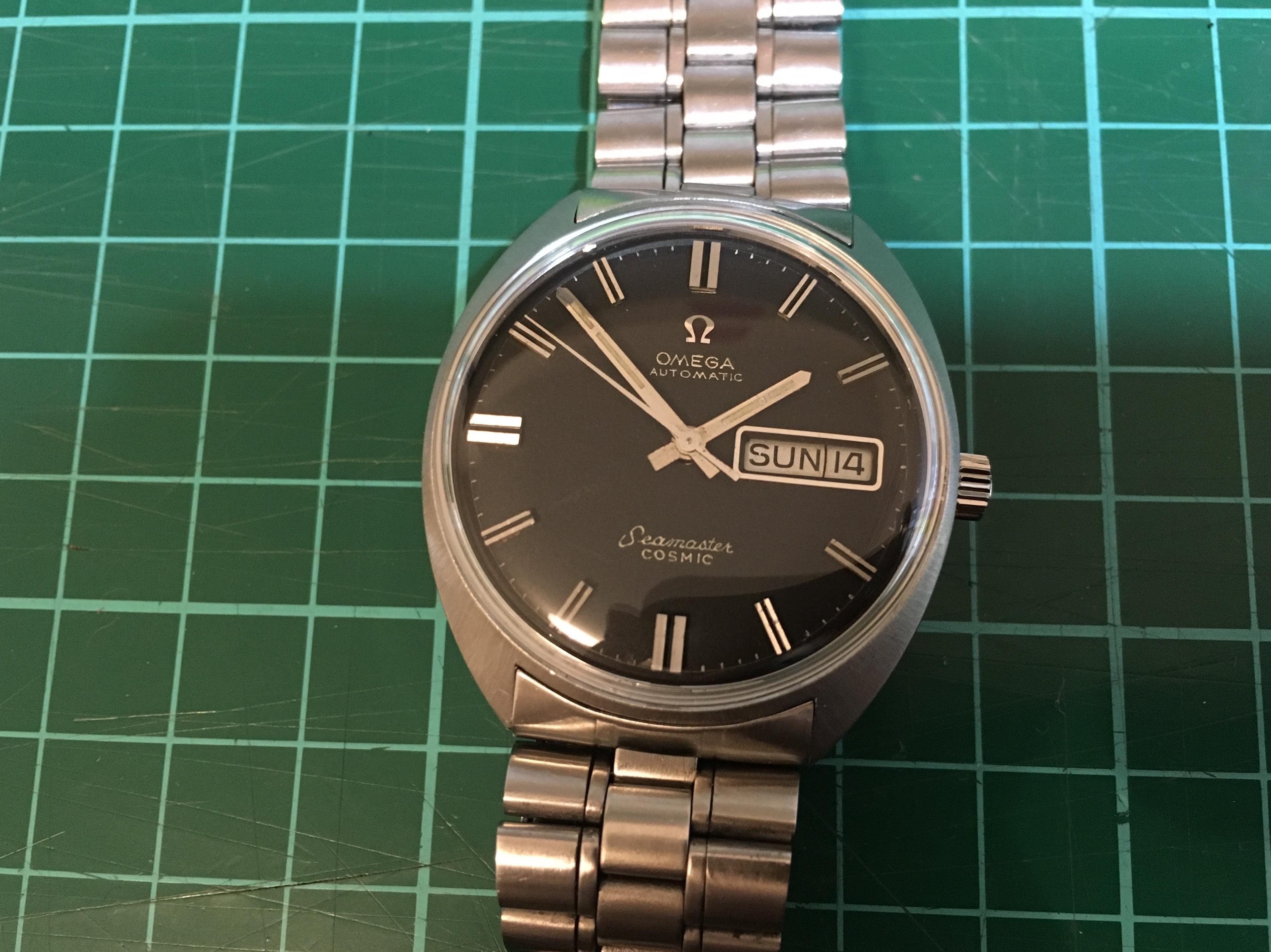

  On 4/3/2020 at 10:54 PM, gary17 said:
It's a vernier I think but it's a cheap one. A sliding ruler type thing 2 point. 1 point on 1 side other opposite side.
Tried it on crystals I know the size of and it's onlt been 0.1mm out on 6 crystals. Sorry if I am late answering I am thinking of buying a omega seamaster professional 300m james bond automatic it's a 2004 model Ltd edition I can have it for 1500 pound all papers and box and all service receipts.so been. A bit sidetracked
Expand
Measuring the inside of a case is pretty tricky. You need a vernier with fine points and you need to push the jaws open whilst simultaneously wiggling the gauge to ensure you get an accurate measurement. Then you need to read the scale before removing it. Ideally easiest to do this with a digital caliper.
Hi
Fantastic work John. I don't have the ring for the crystal.
If it was your choice which 1 would you go for.?
And it has to have the silver coloured ring
In case it helps, this was a Cosmic which I worked on. PZ5123 crystal.
These crystals have a slight lip. That may be what Omega measure in their spec.
And as I mentioned already, the Sternkreuz equivalent (an ATC) will not make with the case and dial correctly, which may result in a loose dial/movement.
