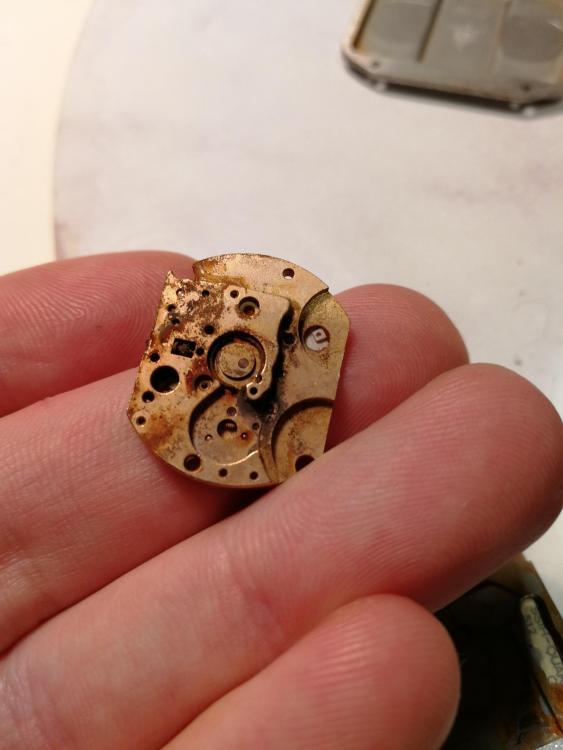

Basically I've stripped it down - can see that someone broke the wiring to the crystal. They have bodged soldered some of the contacts. The general majority of parts are there - it was only missing a crown, battery holder plate and the gasket for the caseback.
The crystal has a light chip in it. Otherwise okay. (it's on the inside).
The circuit board will be cleaned and retraced with tin. The motor is perfectly intact. The Movement plate is totally rusted. I have stripped it down and cleaned it and it looks like it will survive!
You gotta love Swiss quality - no way that chinese parts would survive rust. I have researched and found that the 1320 cal is similar - the running gear is quite the same, the only part I broke on mine was the setting lever - which is easily sourced.
I have broken one calendar retaining screw but no big deal. They were super rusted and I was lucky to get them out.
My ultrasonic cleaner sadly decided to go bust - so I will have to wait to finish this job.
My final step is to remove the stem from the movement hopefully.
The cost of a donor 1320 is around $180 - a donor complete watch with crown is about $300.
I want to at the worst case just get the analog side working - if I cant get the digital side working - no big deal - it is still a grail watch for me on a budget.

Will do, I've ordered a donor 1320 movement.
I managed to clean all the old parts except the minute wheel which is a tad rusty (but may work).
The calendar date ring is garbage, as is the calendar retainer plate. although could be used in a pinch.
If the part was extremely rare, I would have sent the date ring to a dial specialist to reprint - hopefully the 1320 ring matches.
The stem was broken so thats no good. The crown yoke is de-chromed - so will need replacement.
A lot of the parts suprisingly survived. The base plate is really all I need to survive.
