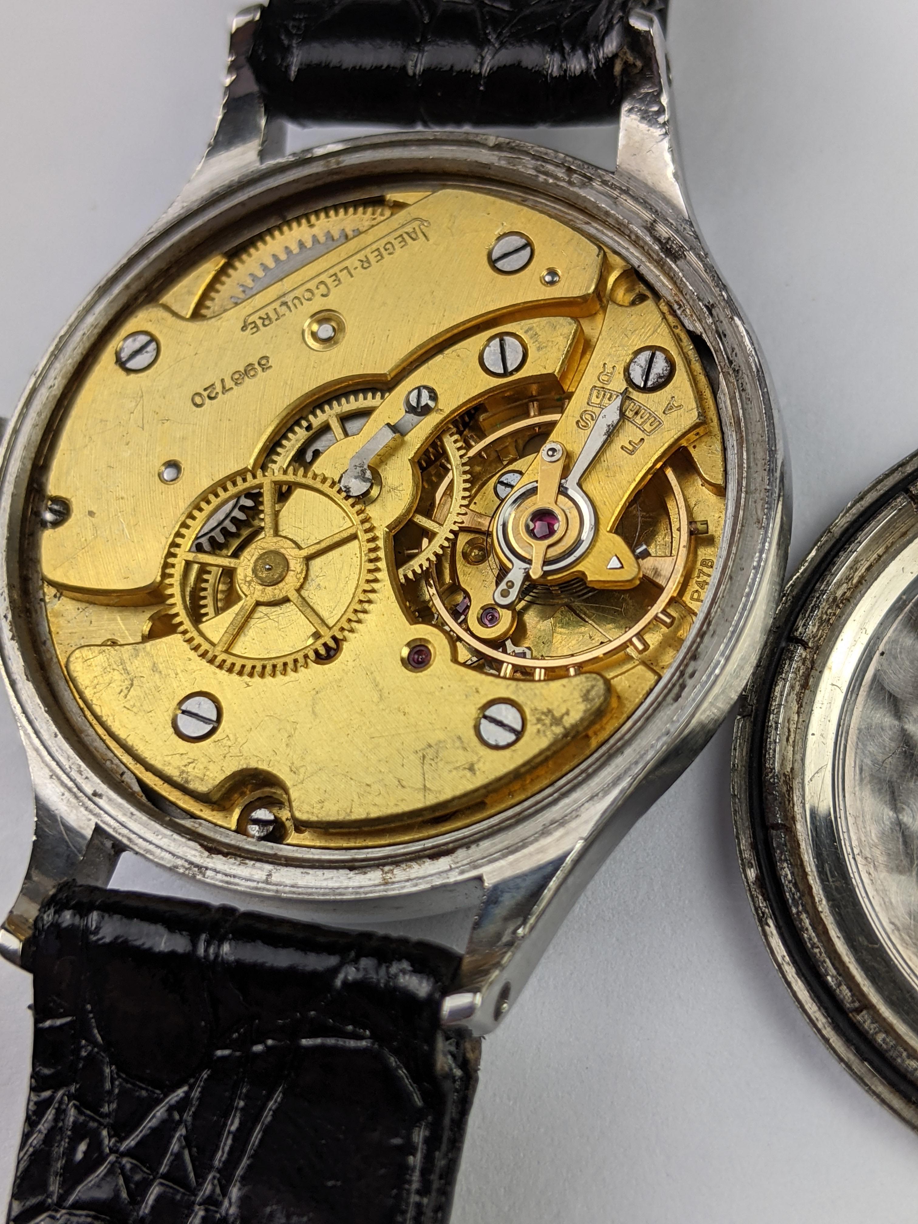

  3. Hello! I recently acquired a Jaeger Lecoultre P478. There are two issues that I have. First, the snap caseback is warped so that it doesn't sit flush all the way around the case. It seems to fit well enough but there's still a gap which makes me wary. Is there a way to fix this? Second, the hands on it appear to be quite old but they don't look like other hands I've seen on the same model, could they possibly be original and I've just never seen one like this before or are they for sure replacement hands? Any help is greatly appreciated! Thank you!

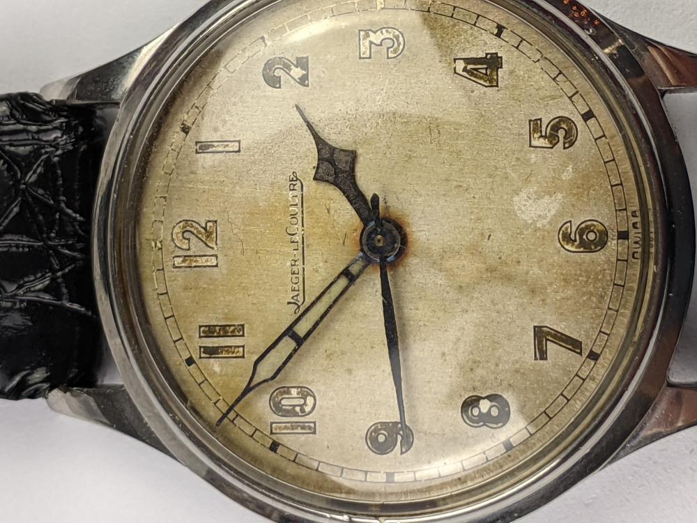

  4. So years ago my grandpa found this watch in a park while walking it during work (he worked as a cop in northern New Jersey) anyway he passed it onto my dad. Neither of them knew much about watches except they needed them to tell time. My dad gave it to me a few years ago when he saw i was getting into watch collecting. Any information would be great. I have been had it explained as art deco which im guessing is referring to the lugs. I haven't been able to find out much on it myself. Thanks in advance for your help!
