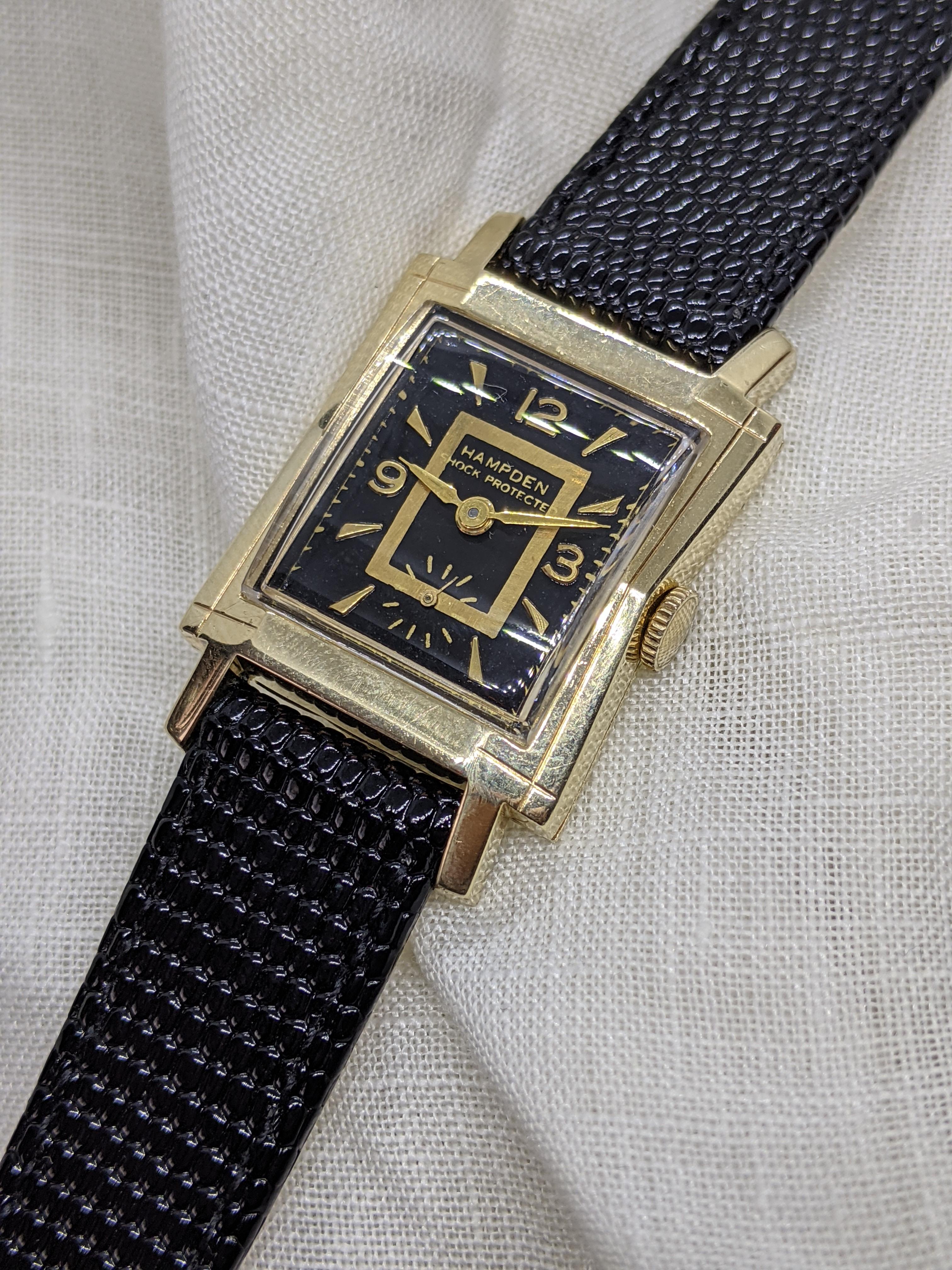

  1. I just serviced this vintage (I think it's from the 1950s) 14k gold Hampden wrist watch. I was looking into their history and everything I found about them said that they went out of business around 1927 and sold everything to Russia. I know that there are other Hampden wristwatches from the 1940s and 50s (swiss made) but I can't find any further history. Was this brand trying to be revived? Movement is signed Hampden too, it's an AS 970.
