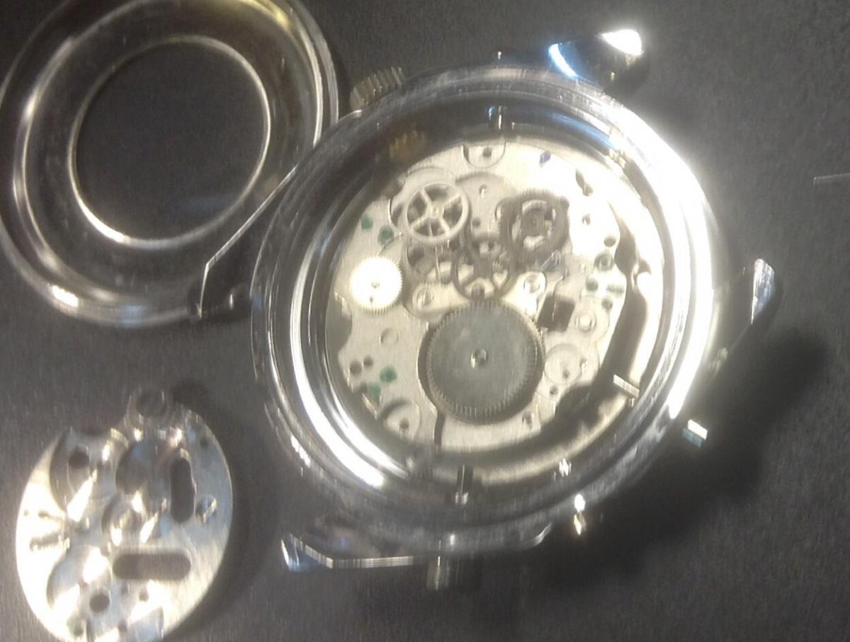

Oh well took the plunge after all its just a cheap watch so I'll kee0 it and purchase another for my pal the owner, because I think
I made a BIG bloomer, but then its all part of the learning curve, and I have a none working watch that I can experiment with.
I thought I would remove the the oscillating weight and follow the rest of Mark's
instructions with the understanding that the Watch Movement was at risk as not movements are the same and any problems that may occur would be due to my
lack of knowledge.
I then removed what I think is called the Ratchet Plate and then to my surprise
the cogs were not fixed they all fell away from their locating positions to a point I
did not know what went where, I should have known as it just a cheap movement.
Is it possible to purchase movements to replace this one or does anyone know
the way to get these cogs into their correct place.
I don't regret what has happened as its all part of learning and after all I now
have a movement that I can mess with.
Perhaps I should have removed the Hands & Face to fix the Winder position.
Also does anyone know of a stockist who keeps a large variety of movements.
Kind Regards
Tony
Picture 1 = Weight Removed, Picture 2 = Ratchet Plate removed, Picture 3 = Cogs Picture =Cogs removed

You should have removed the movement from the case and then as you say above.
Dear George. (Is it George)
Thanks, yes the next thing I'll try is seeing if it can be done from entering via the Watch-face, as I now have a scrap Movement to practice on, so its not all bad news, its just in the YouTube Video its shown as a repair to be carried out from the back of the movement.
By the way I did completely remove the movement from the WatchCase and realised the WatchFace and hands would be safer
if the repair is to be carried out from the back of the movement, so I refitted the movement temporally.

Hi Tony, you should invest in a couple of movement holders, one large and one small. Apart from easier access you are less likely to encounter the type of problem that yo encountered. Another thing that is vitally important for someone setting out in watch repairs, is to take lots of pictures as you proceed. Believe me you really can't take enough.
Keep on practicing, because one of the most important things to acquire is a delicate touch.

Because the side of the Movement was quite thin and could easily bend I decided to put it back into its case as I was approaching
the Task in hand from the back of the watch, but, don't think with a lot of care taken could have avoided those cogs jumping out of
position when I removed the Ratchet Plate, as they were not anchored in any way, they were just laying on the Movement, after
all its a cheaply manufactured Chinese Watch, and for what its cost its good value for money when I think of the knowledge I gaining
thanks to you guys "Many Thanks".
