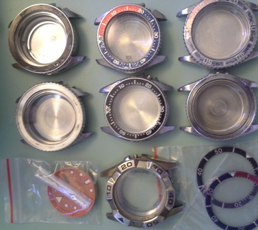

Before:
After:
:D
Too many beers! But I'll get it back together... eventually!

I'm in much the same stage as Bob. I bought a 7s26-0030 diver from a seller in the Philippines with the idea that it would be a fun restore project.
It was a non runner when I got it and I think this is the main culprit.
Pieces of the broken pallet jewel had gotten wedged in the train wheels.
Here's another pick of the pallet.
I lost the bezel click while cleaning the case in my ultrasonic, so I'm currently trying to make a replacement. I'm also looking for a good deal on a 4 o'clock crown 7s26 movement for parts. I hope to have some "after" pictures sometime this year. I'm thinking of replacing the dial and hands with a Tudor Snowflake set from Dagaz.

In my case, I just got a little ahead of myself. I'm still very much a beginner, but I couldn't wait to tear into that watch. I could buy a brand new Seiko SNK809 for about $50 and use the movement from that one, but I'll learn more and hopefully have more fun rebuilding it myself and replacing parts as necessary.
I look at watch restoration as a hobby not unlike classic car restoration only it takes a lot less space and money.
