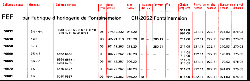

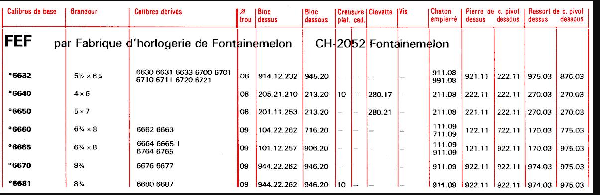

On the off chance I wondered if anyone would be clever enough to figure out which incabloc shock spring (lyre style) the FEF 6620 uses, I tried to figure it out myself but perhaps because I've not had to track one down before, i didn't get very far. I have some very vague measurements (could only measure the good spring, in the setting) I believe it's ~1.7mm width by 1.1mm length.
Trying to avoid buying a balance complete for the sake of an incabloc spring.
http://www.ranfft.de/cgi-bin/bidfun-db.cgi?10&ranfft&&2uswk&FEF_6620
