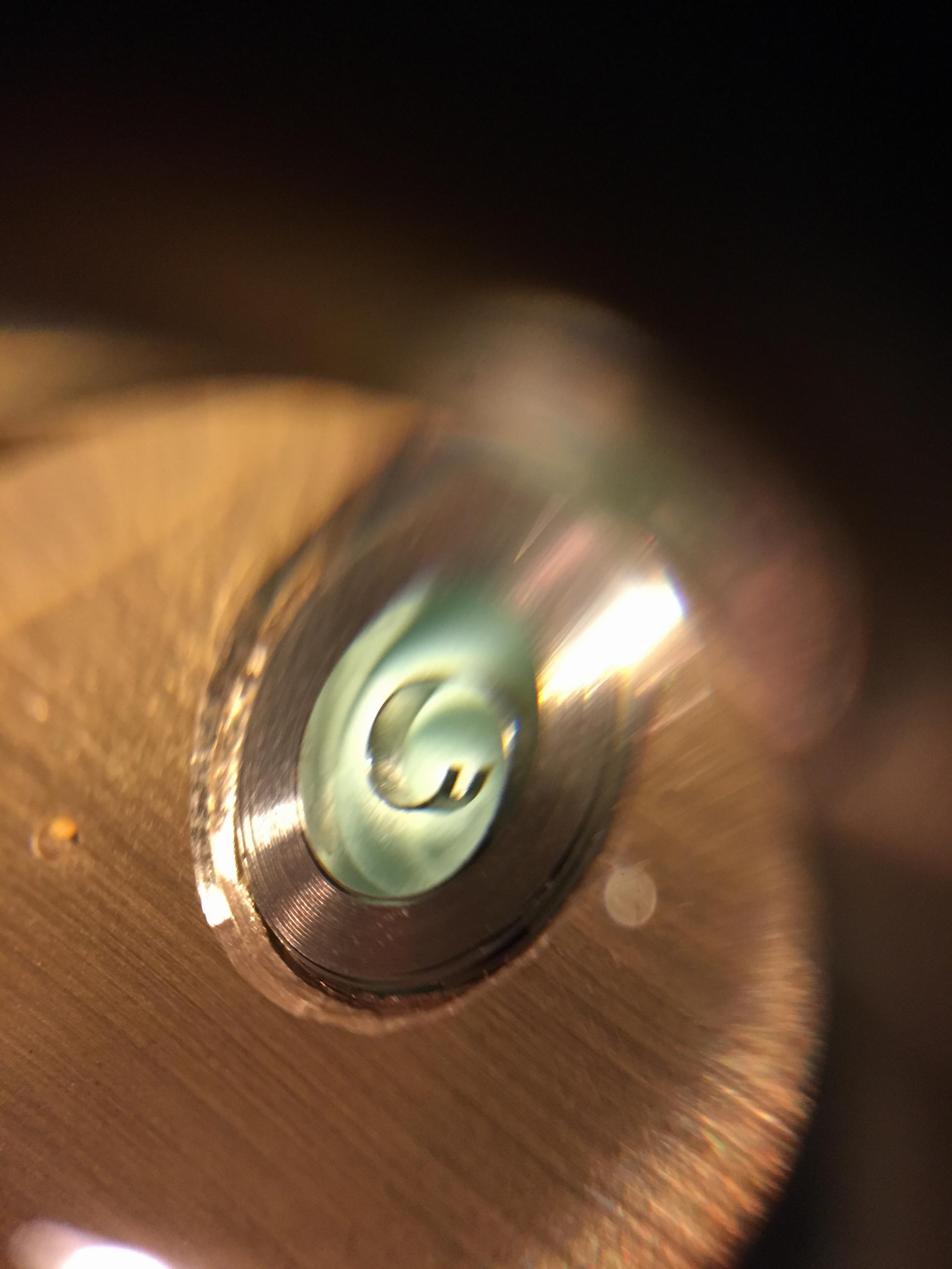

So I just picked up used bergeon mainspring winder set like mark has, but smaller. I go to wind a mainspring for a watch I'm working on, and after it's in, I slowly cock it backwards to release it from the arbor hook, and the mainspring end breaks right off. What is the proper way to remove the winder?
Which end broke off? The arbor end or the end that attaches to the barrel?
