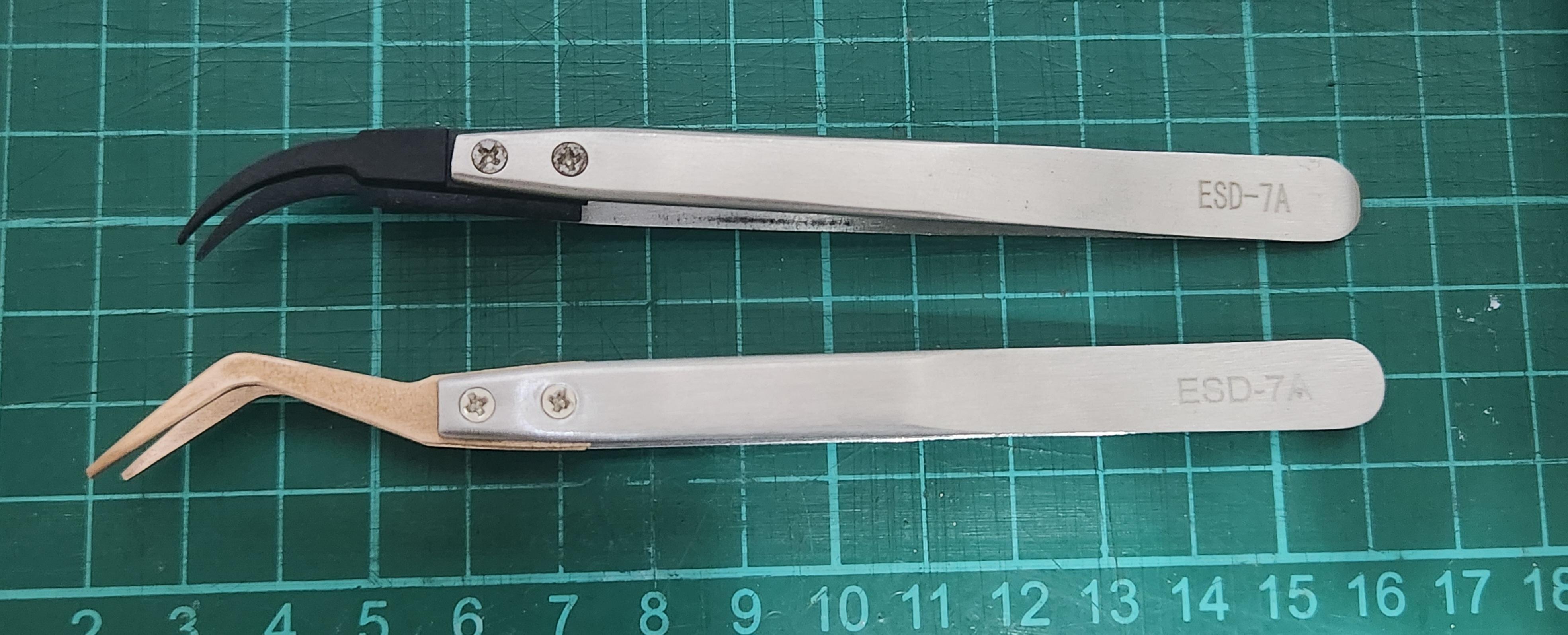

So I thought of upgrading to bronze. But I can't seem to find curved bronze tweezers. And Cousins price for a pair of Bergeon straight bronze tweezers is around £45.
A couple of months back I had the idea of swapping out the carbon fibre tips of my tweezers and putting in bronze tips. And that is what I did.
I got a piece of 2.0mm bronze sheet from AliExpress and cut out 2 curved tips and replaced the carbon fibre tips.
I'll probably thin down the tip further gradually to a point where it still has strength to draw back thick yoke springs.
