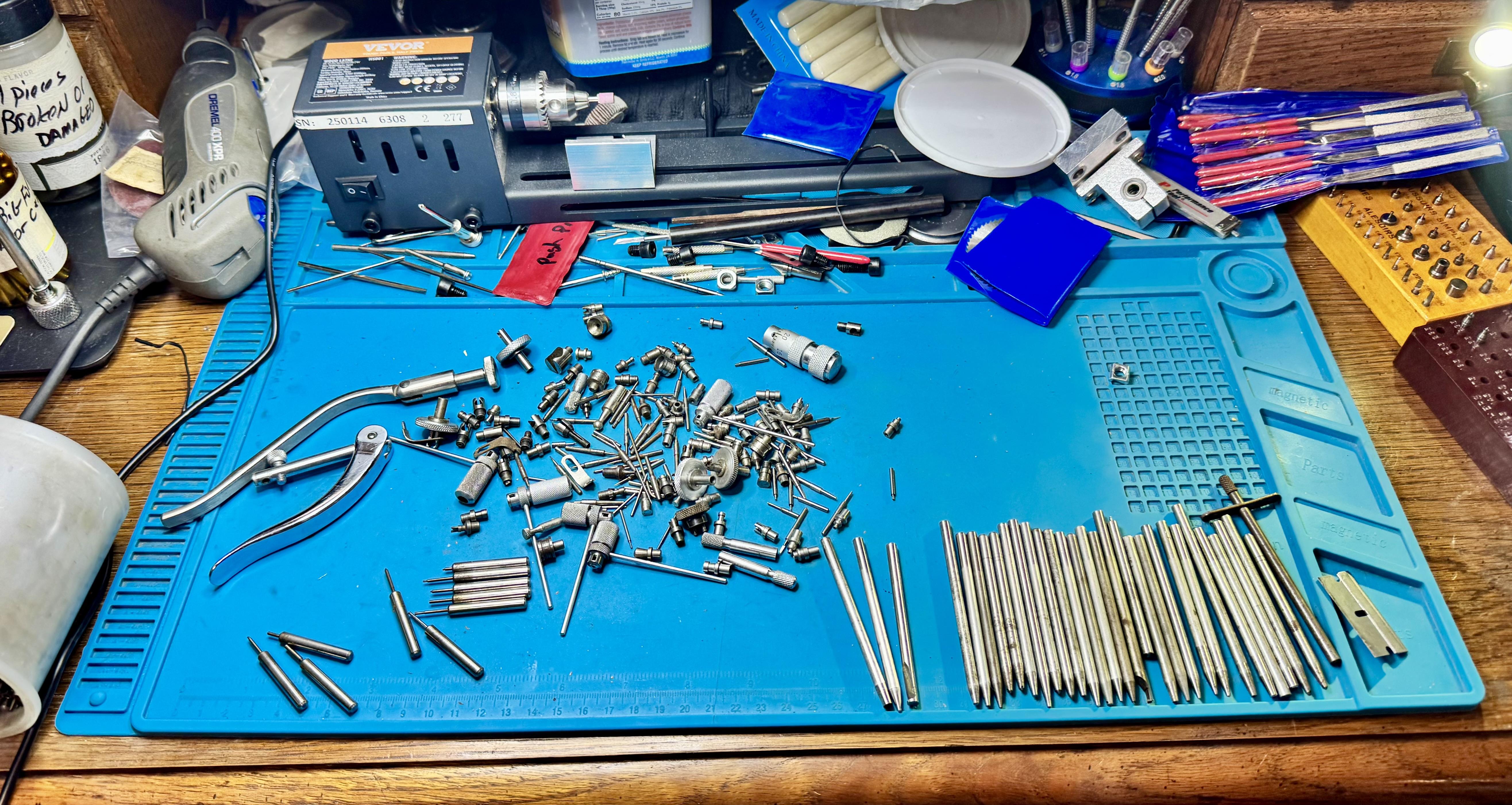

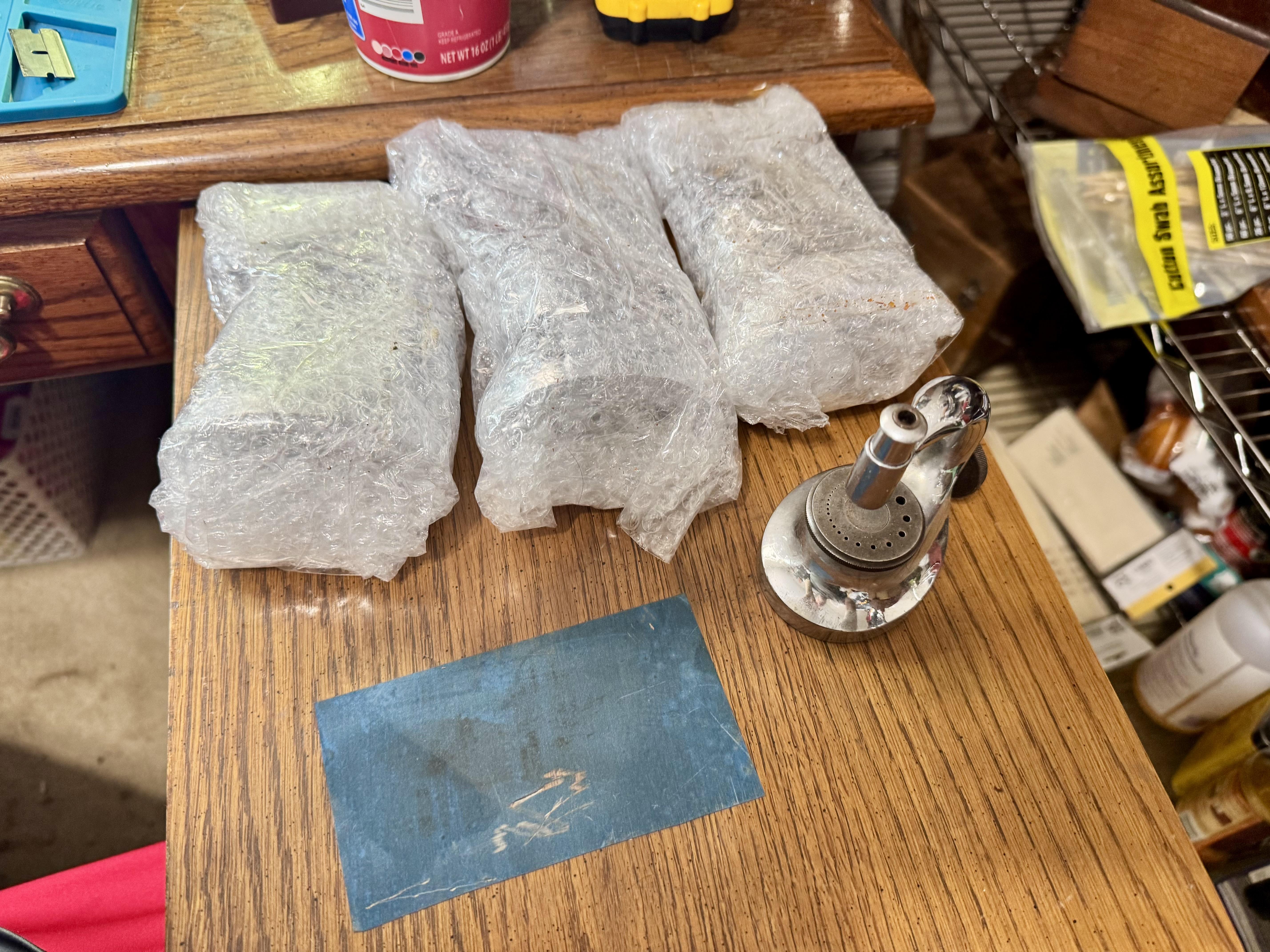

  I still have shipments coming in and I’m able to do some unpacking and sorting through everything with one hand. I’ve added some photos of this weeks haul(s) and things relevant to this question.
   My desk is normally nice and organized but today it is in bad shape
Normal View
A disaster trying to organize and sort through all this with one hand 😂

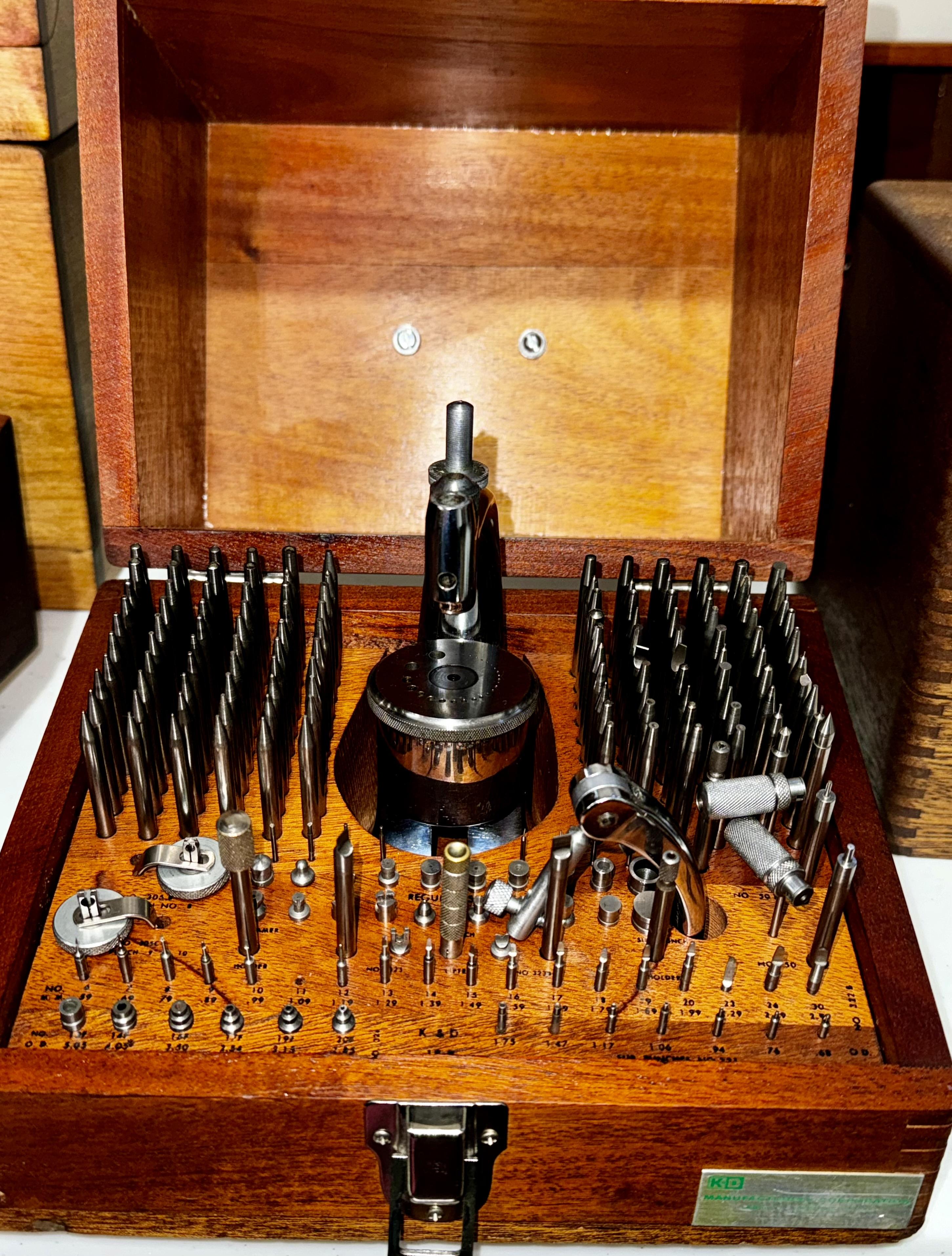

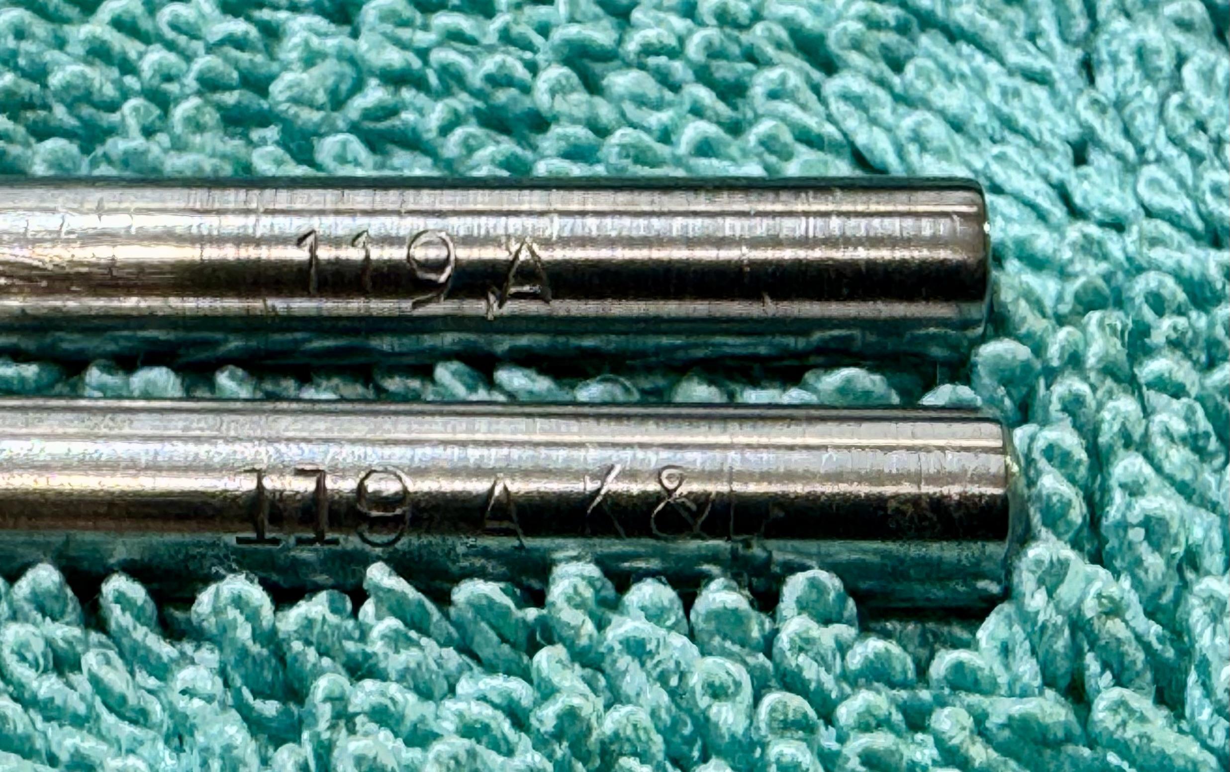

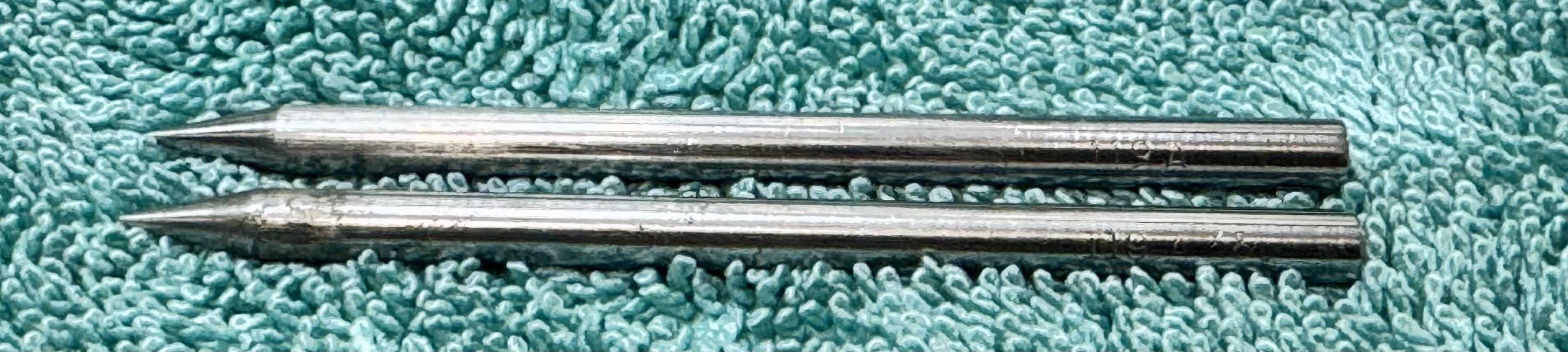

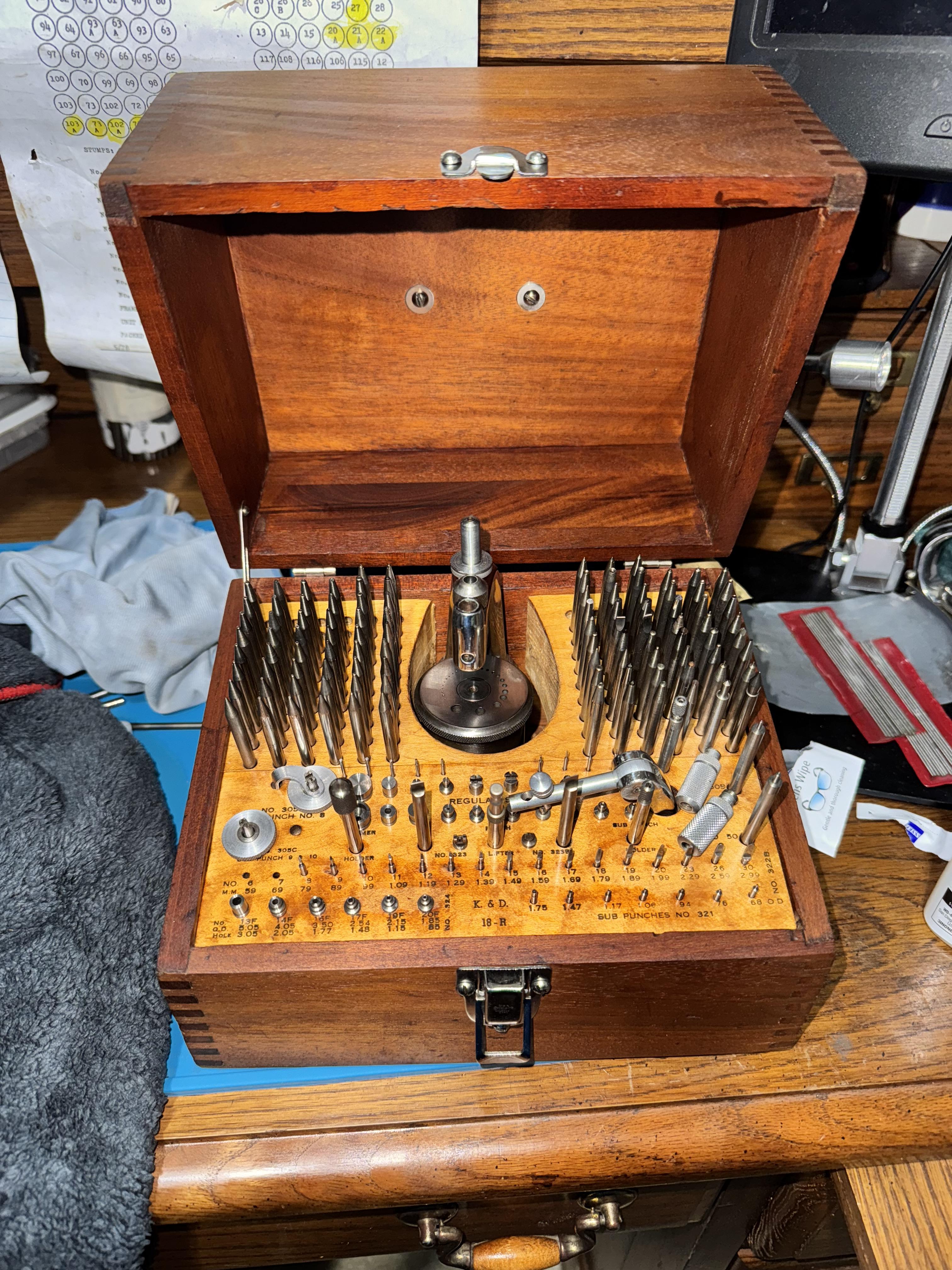

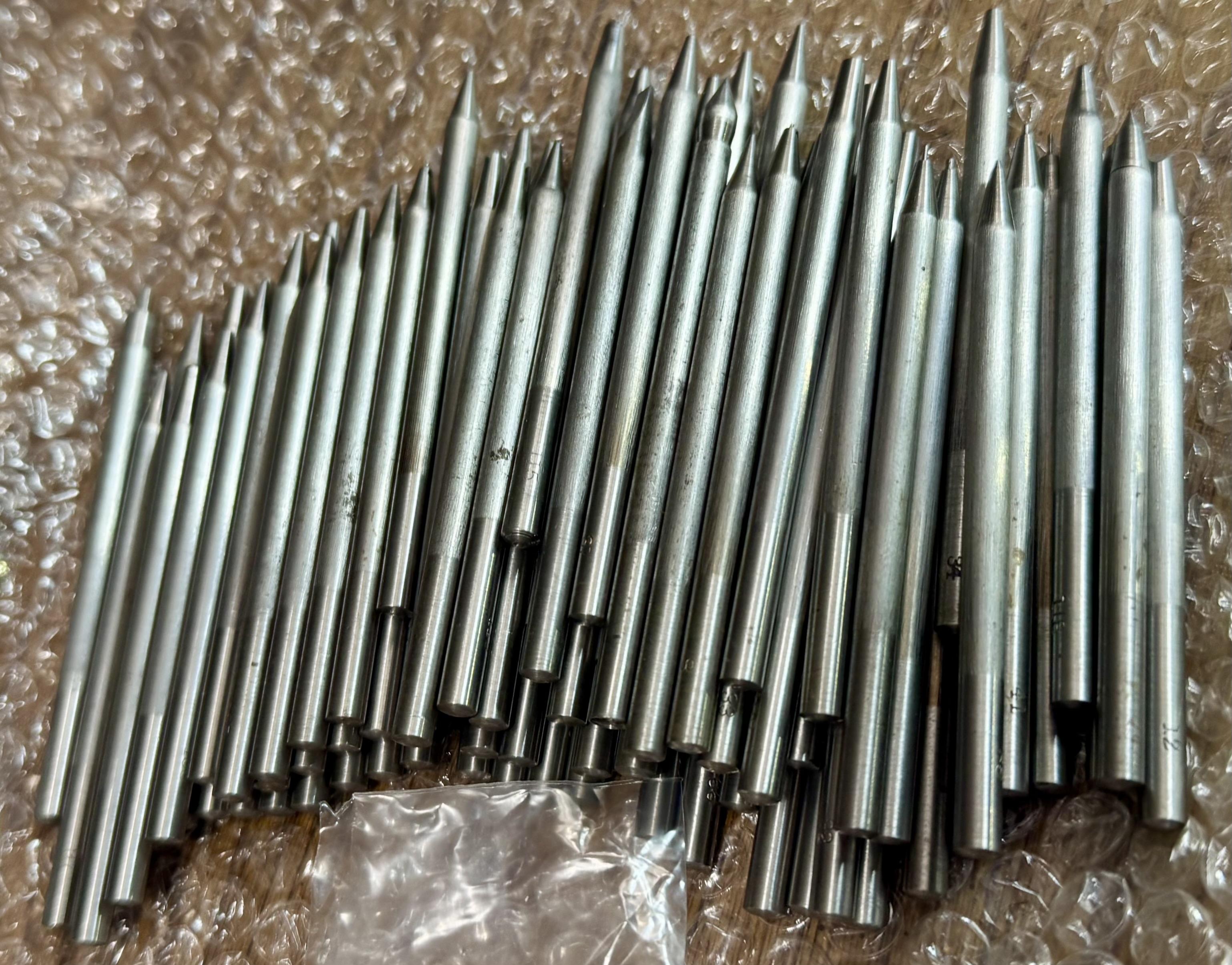

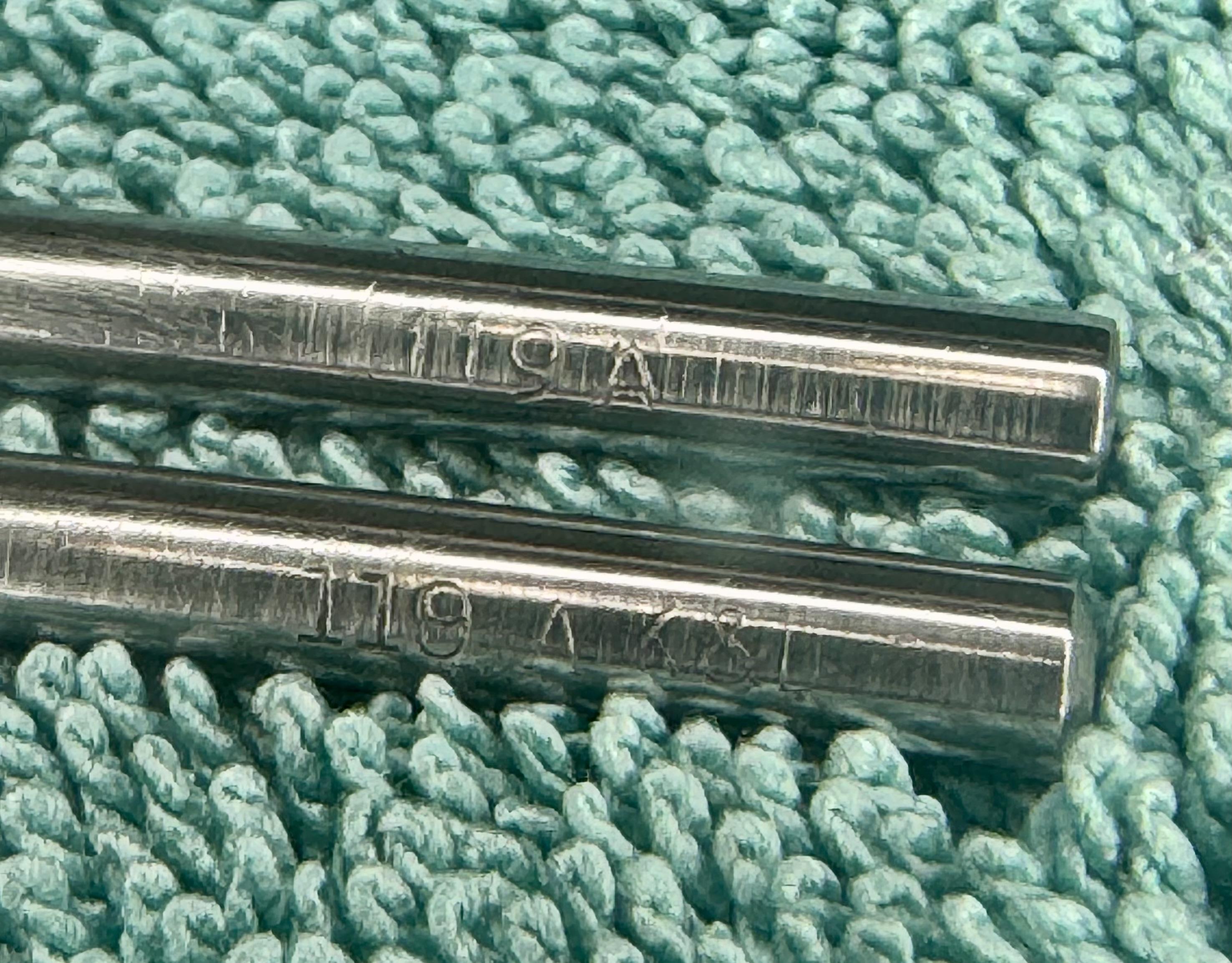

One large lot of staking sets showed up yesterday and one of the 18R Deluxe sets is different because almost every stake in the set is only marked with a number.

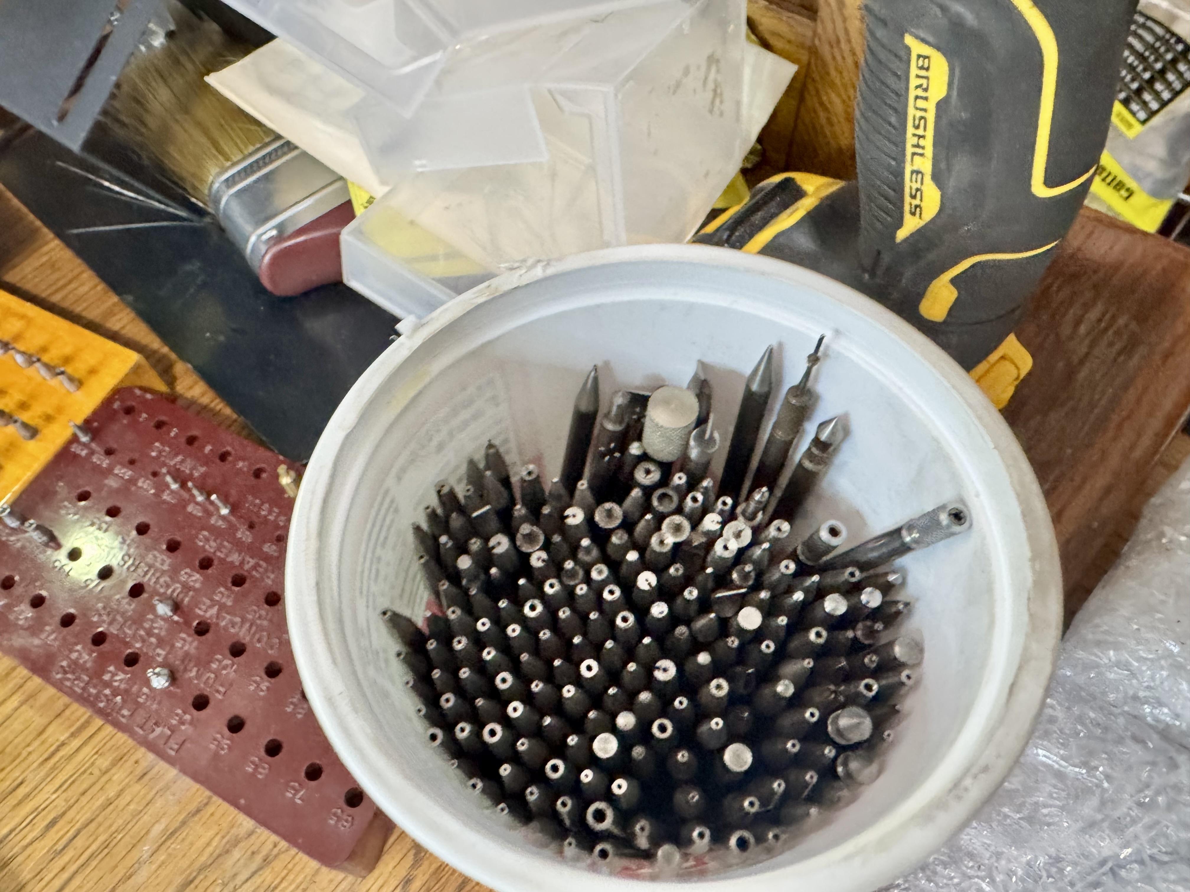

Non K&D or C&E short stakes
Normal K&D stakes
Anvils packed tightly

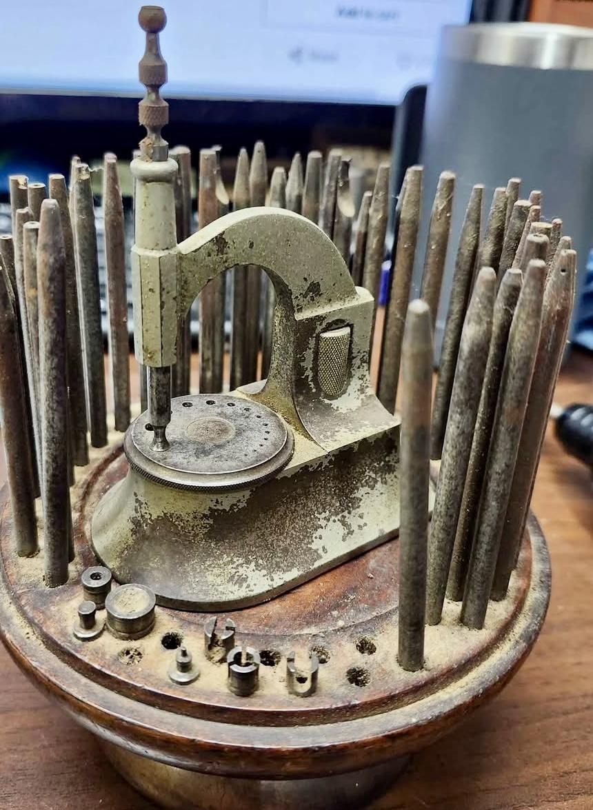

E. Rivette staking set around 1890-1905 I am very excited about

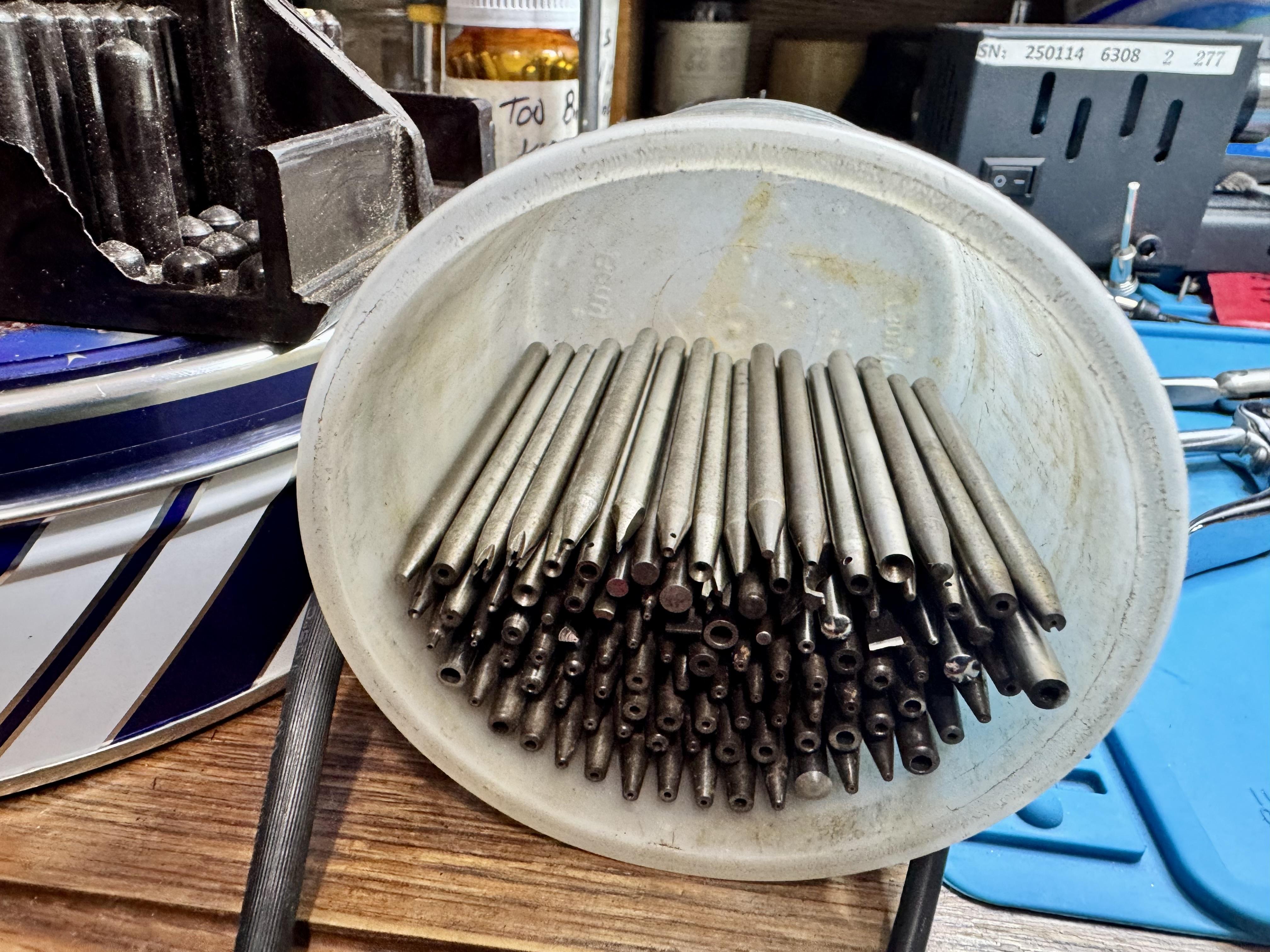

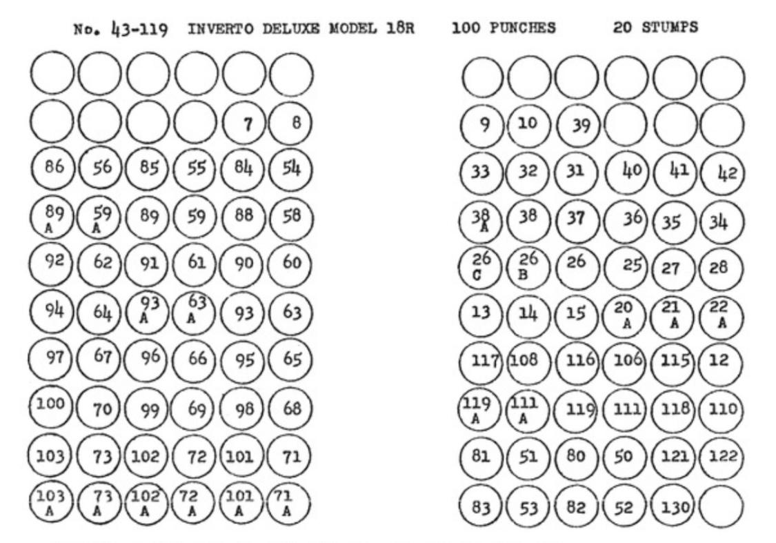

There’s more than a few marked with a number and the K&D logo, but the majority are just numbers only.  I’ve noticed any stake that wasn’t listed on the original 100/20 set build sheets have the K&D logo but the standard stakes for those sets are just numbers only.
This is about the 4th or 5th K&D 18R Deluxe set I’ve gotten in the last year that had these type stakes.
   I somewhat remember reading that K&D offered a Student version of their staking sets.  Is it possible that’s what these are ?
    They are always in the newer style 18R Boxes that don’t have the yellow labels. The ones they made closer to them going out of business.  Like these but with the actual Micrometer Knob
   A couple have had a small plate on the outside of the box with the K&D logo on them.
The stakes are identical in every way to the “Normal” K&D stakes in style and dimensions, except for the labeling.
Suspected K&D stakes with no logo
2 119a stakes side by side
  Had anyone seen this or know about a student series ?
Thanks for any guidance you can provide.
