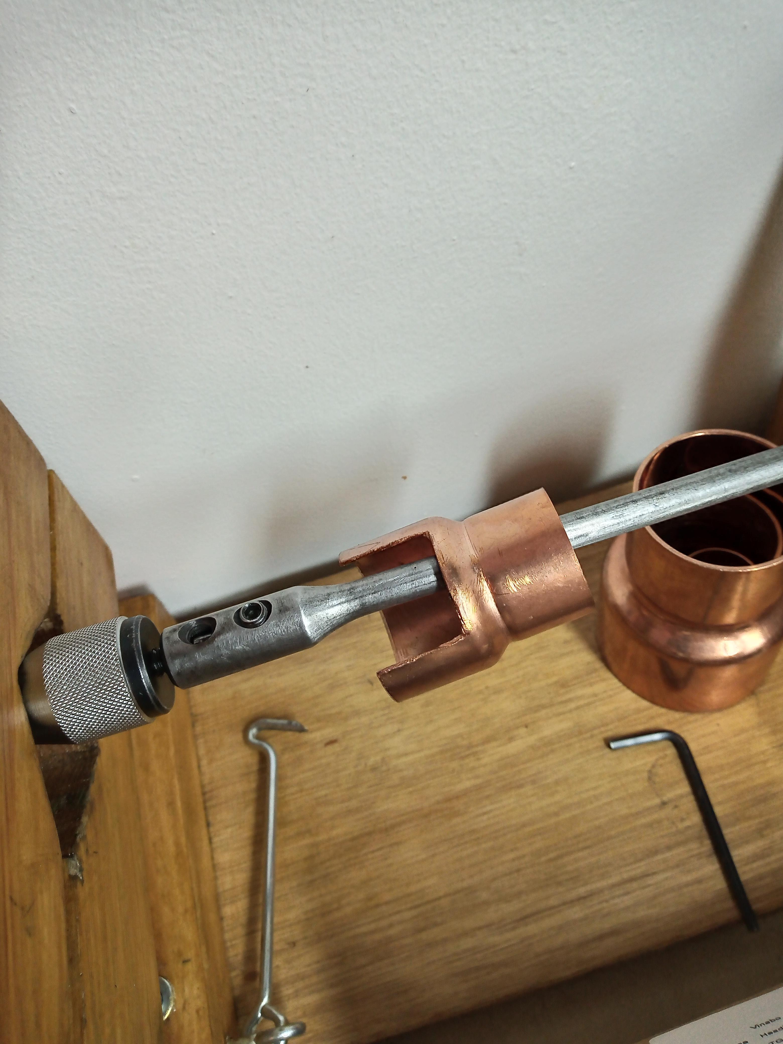

Hi  in regard to your questions,   The springs should ideally removed from the barrel but to do this you need a mainspring winder that are quite expensive for a one off. Or you c a make your own see Google “ joes mainspring winder”. I have made two and they work well, you will also have to source some tube for the retainers.
the gathering pallet cann be removed using levers ( mini crow bars) again I made my own no problem.
the case can be glued using evostick wood glue but bind the case together to close the crack. When solid you can use wax sticks (used for furniture) melted and rubbed in to cover any blemish left.
best to clean the case and then use bees wax to polish, a bit of elbow grease needed
do not clean the dial with anything other than warm water and a couple of drops of mild soap. Try on an inconspicuous part first. There is a product called MILIPUTTY in various colours on eBay that can be used on cracked enamel dials depending on how bad it is .
