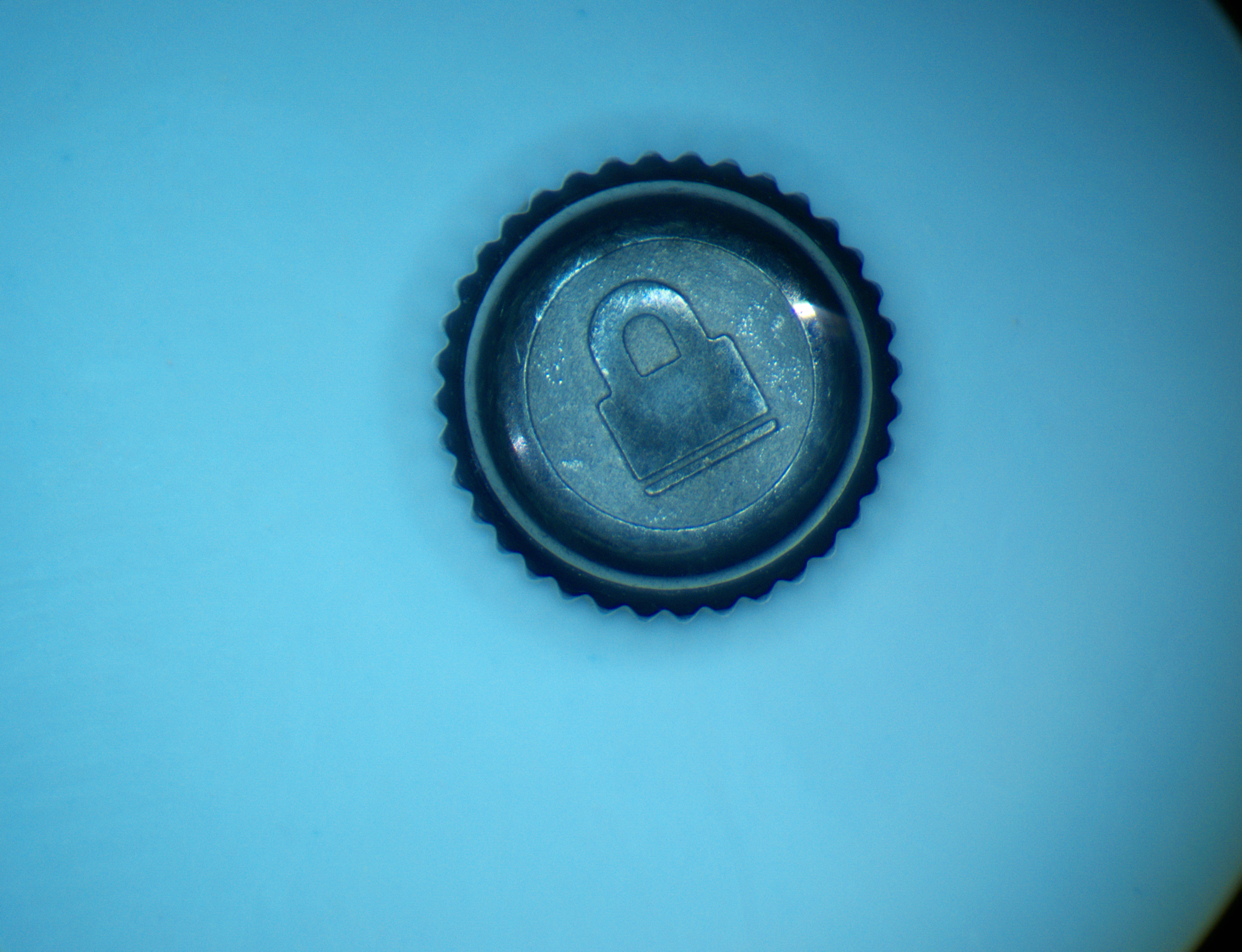

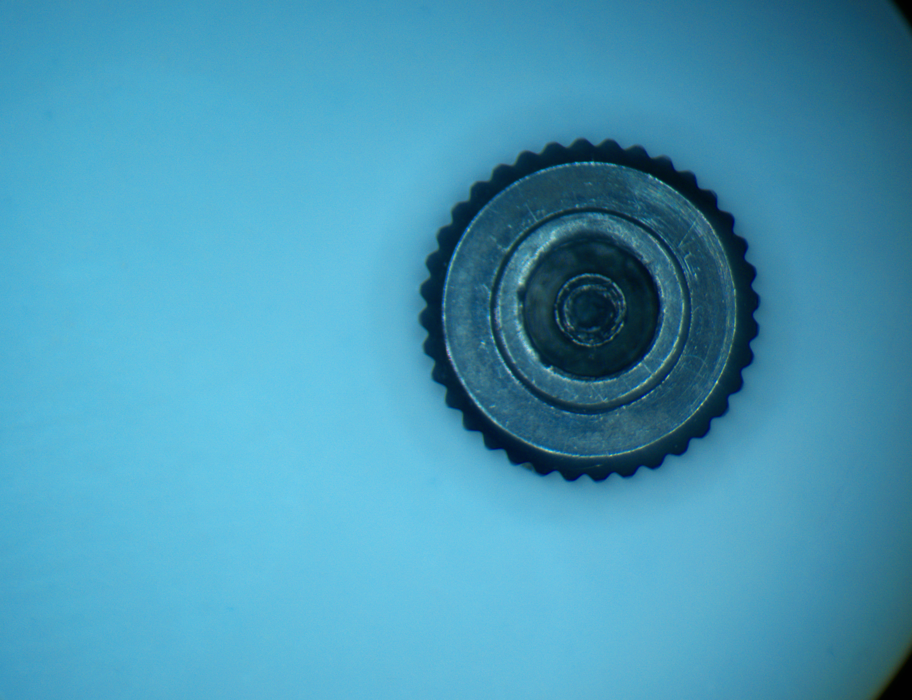

I am working on  the crown of an EMG DL63. The stem snapped and there is nothing to grab.  As a last resort I was successful in drilling a hole in the middle of the broken stem.  I was planning to epoxy the filed eye end of a bent needle in the hole to see if I can remove the stem (see first attached image).  Now I know this is likely not going to work, but what the heck it is a last resort.
Anyway, as I was heating the crown to release the locking agent my heating plate seems to have malfunctioned and heated up to almost 500C before I noticed and this resulted the chrome to yellow (see second image crown color in comparison to the first one).  Am I right in assuming that I can try and reverse the discoloration by buffing it with a little metal polish?

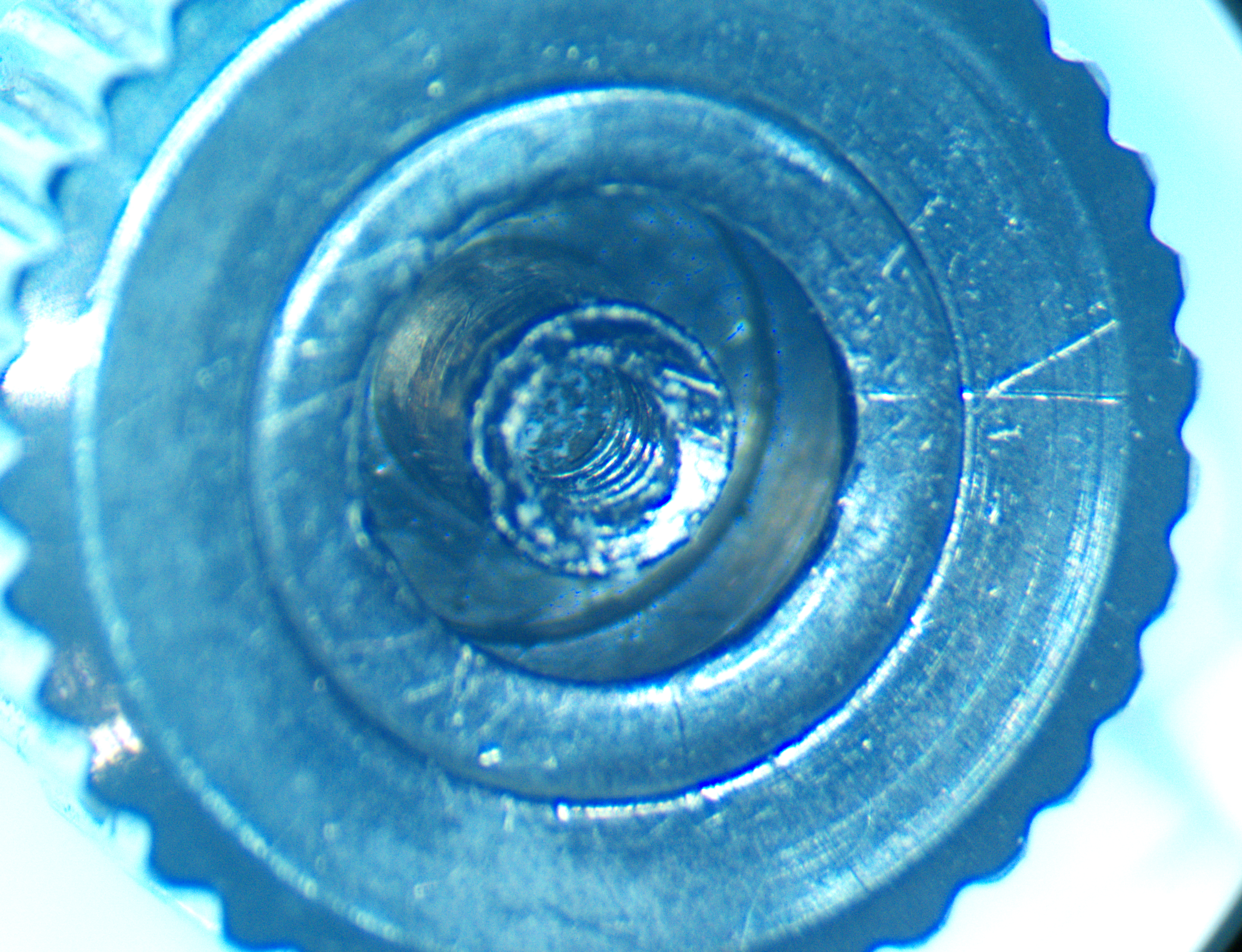

Further I am looking for the size of the two gaskets that are in the crown.  I was initially unsuccessful in removing them and I had to soak the crown in acetone to remove the gaskets.  I measured the sizes in the third images.  Can I assume that is the size of the replacement gasket?
This is a modern watch, the crown is definitely made from solid 316l steel. You must have heated the crown to some 200C caused the surface colour to change to light yellow. It's similiar to steel tempering. Yes it is the chromium oxide that forms during the heating that gives rise to the colours you see as you know stainless steel contains chromium. The fact the crown is SS lead me to a question, you've never heard of the alum method? Because alum would work perfectly in this case, instead of drilling, which, there is always a risk of damaging the crown, I would just let the crown chilling in some warm alum solution for 1-2 days and the job is done.
Sure can but the thing is the crown is not just mirror finishing, the lock symbol is polish while its background is some sand-blasted finishing so it would be hard to replicate that. You can buff it all shiny but losing the sand-blasted finishing means it won't look exactly like before.
Gasket is always tricky to me. I would try to use some gasket that look closest to the broken one in term of thickness and diameter, and check if the replacement gasket fit with some friction to the case tube.
Lastly you can still use alum at this point.
