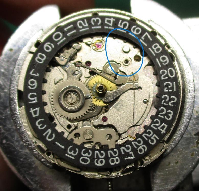

I am missing whatever is supposed to put a little pressure on the date wheel. Can anyone please show me what the part or spring looks like and where it goes so that I can one? Yes I do need to clean up some of the grease.
What other parts have you got apart from what's in these photos?
Edit
I presume the parts you're looking for are the set lever (25) and set lever spring (26), but can't find anything at all for yours.
These details are from an 11ANAC which may work
Edited by AndyGSi
25 & 26 go here. I take if you've got the cover plate?
31 & 32 are the click and spring for the keyless works.
Edit
Just realised that 25 & 26 are also part of the keyless works but the 26 spring is the correct shape.
This is from the AS 1916 parts list which looks like the base calibre.
Edited by AndyGSi
I have the guard and a large assortment of springs.  I'm sure I can find one that works.  Thanks for your help.
