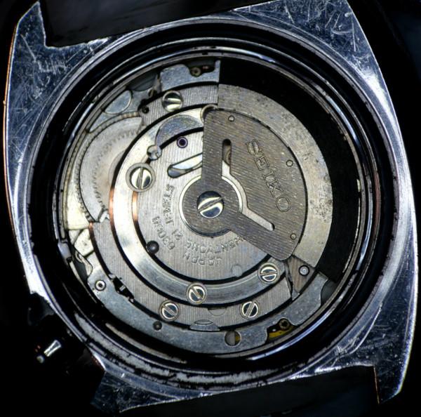

The model I'm servicing is from July 1976. The known issues were a stem malfunction and obvious rusted hands.
As I haven't taken an worthy picture of the initial state, here is a picture from today, with the original and dirty glass but restored hands.
Before opening it an additional issue appeared ; the watch suddenly stopped. Due to a crushed gasket and maybe old greases, a black paste migrated in the movement, between a pinion teeth.
For the movement my cleaning process was pretty simple and I obtained good results.
I pre-cleaned in warm water with soap, q-tips and tooth-brush.
After drying the parts, I washed them in lighter fluid, then inspected them one by one and cleaned them again when needed.
Final rinse with IPA.

I made my first Cousins order, with new oils and some mainspring (thanks @Knebo for the inspiration 😉 )
 For the 630x movements I ordered a GR25341X for ETA and a less expensive Seiko S6319770.
As the Seiko one needed a cleaning, I choose to give a try with the GR25341X. A bit tight for the arbor, I had a hard time to fit all in the barrel.
I also used the Moebius 8217 I ordered at the same time, but I was surprised that it doesn't contains any graphite.
Question : Does this Moebius 8217 replaces well other barrel greases for automatic watches ? What are the practical differences ?
