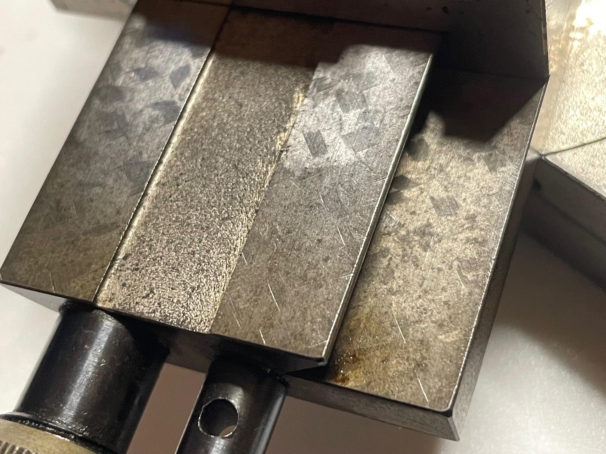

Any surface that has curling or frosting (small scrape marks spread over it) is explicitly intended to have an oil film. The scraped points act as tiny well and stop the oil being pushed away, so it can be carried between the two surfaces.

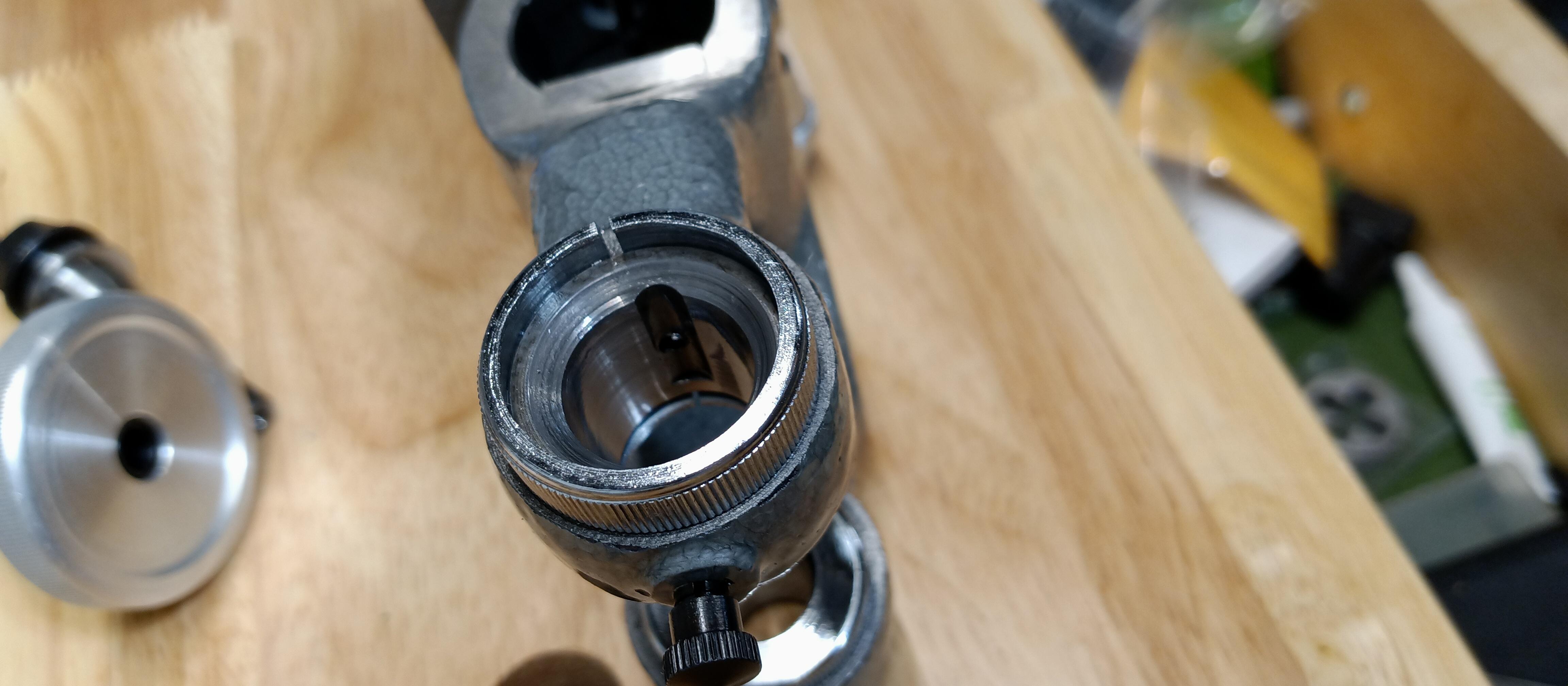

Pic #1: So the entire rear bearing spins.  The keyway pin, and everything connected to it, up to the split metal ring, all spins.
Pic #2: There is no oil deposit hole in the read bearing, but there is a gap between the bearing and knurled metal ring that I think is where oil makes it to the spindle.
Pic #3: The oil well at the bottom of the front bearing.  I believe oil is deposited to this in a similar fashion as the rear bearing; the oil travels in the gap between the outside of the bearing, and the inside of the housing.  Once it reaches the bottom, it is  picked up by the spindle.

Spin the knurled ring that has a split in it. Split to the top then you will see the oil hole that lubes the bearings. The ring turns to expose and recover the hole, it will be tight to turn.
It should turn by hand, thumb and index finger.
