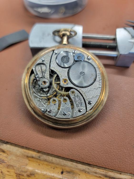

Rockford PW Grade 566

this brand name has been around since the 1880's, they made what was called dollar watches, easy to look up on the web, most are not expensive but that does not take away sentimental value, the model number might be hard to find as this style could have been made for several decades.......
