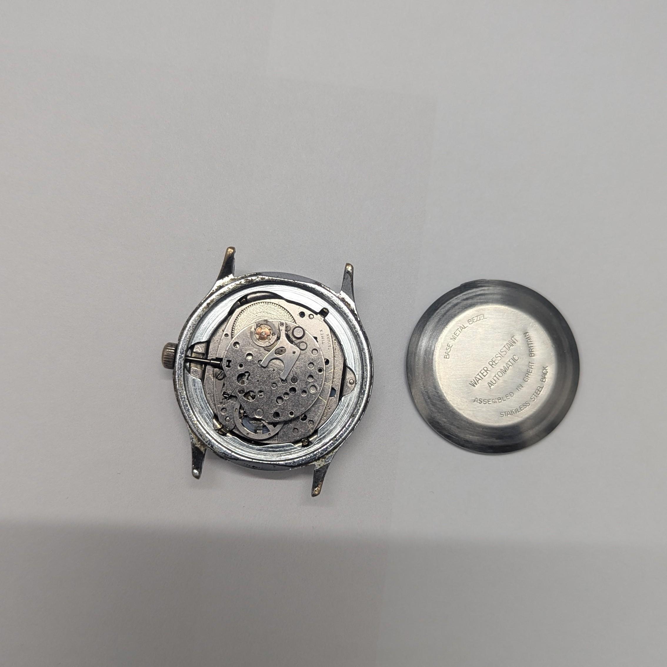

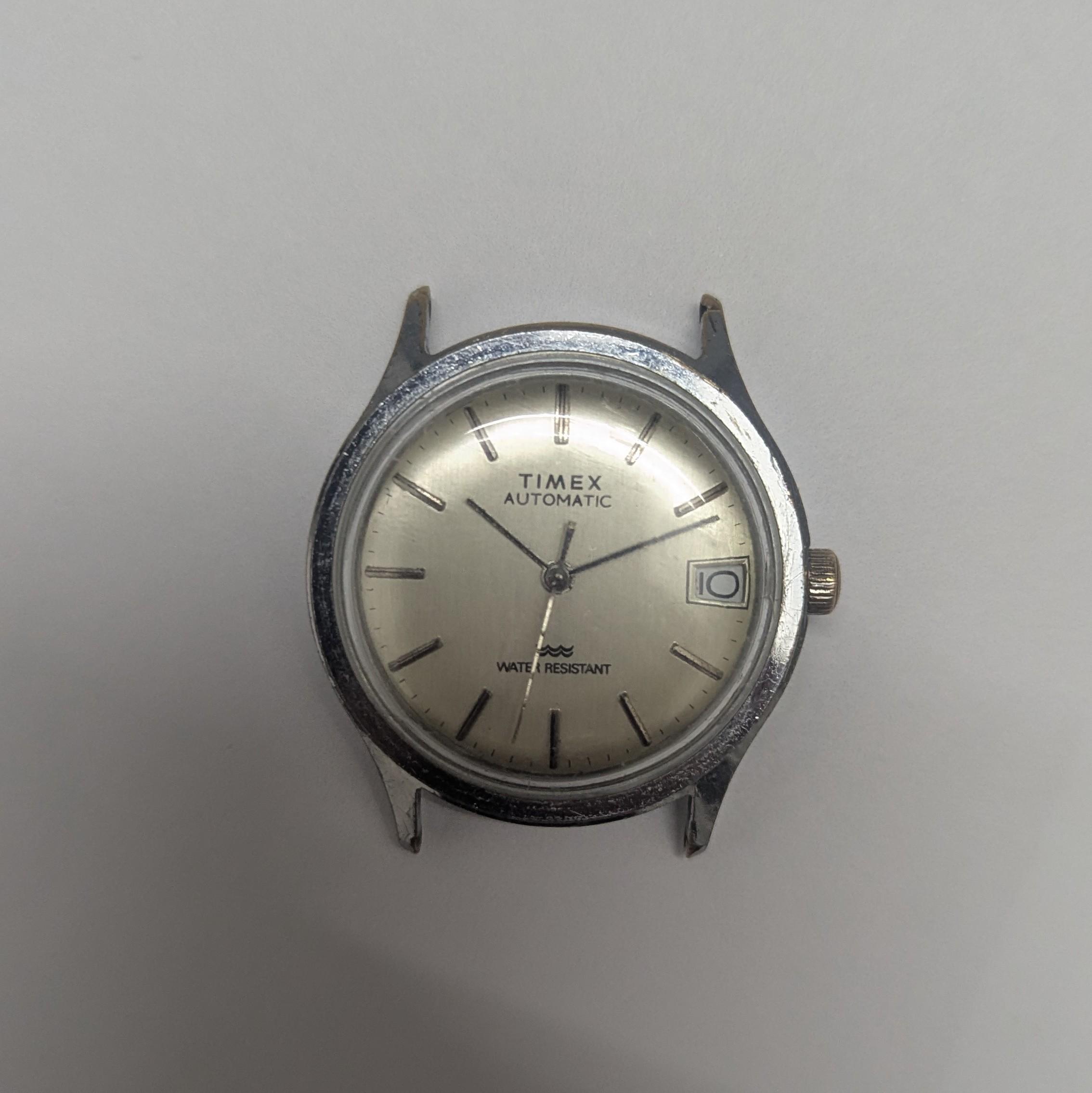

I have this Timex vintage automatic with M25 or something similar movement. It seems it is supported by metals at the bottom. How can I get it off?
You're going to need a crystal lift tool (12-16 brass claw clamp driven by a screw). Even if someone glued in the crystal (incorrectly), the crystal lift will be able to grasp it and flex it inward to pull it out.
The original crystals were never glued, and this one is almost certainly original.
The watch doesn't wind. I wanted to open and see what's going on.
I have ordered the crystal lift... let's see what happens.
Thanks everyone!
