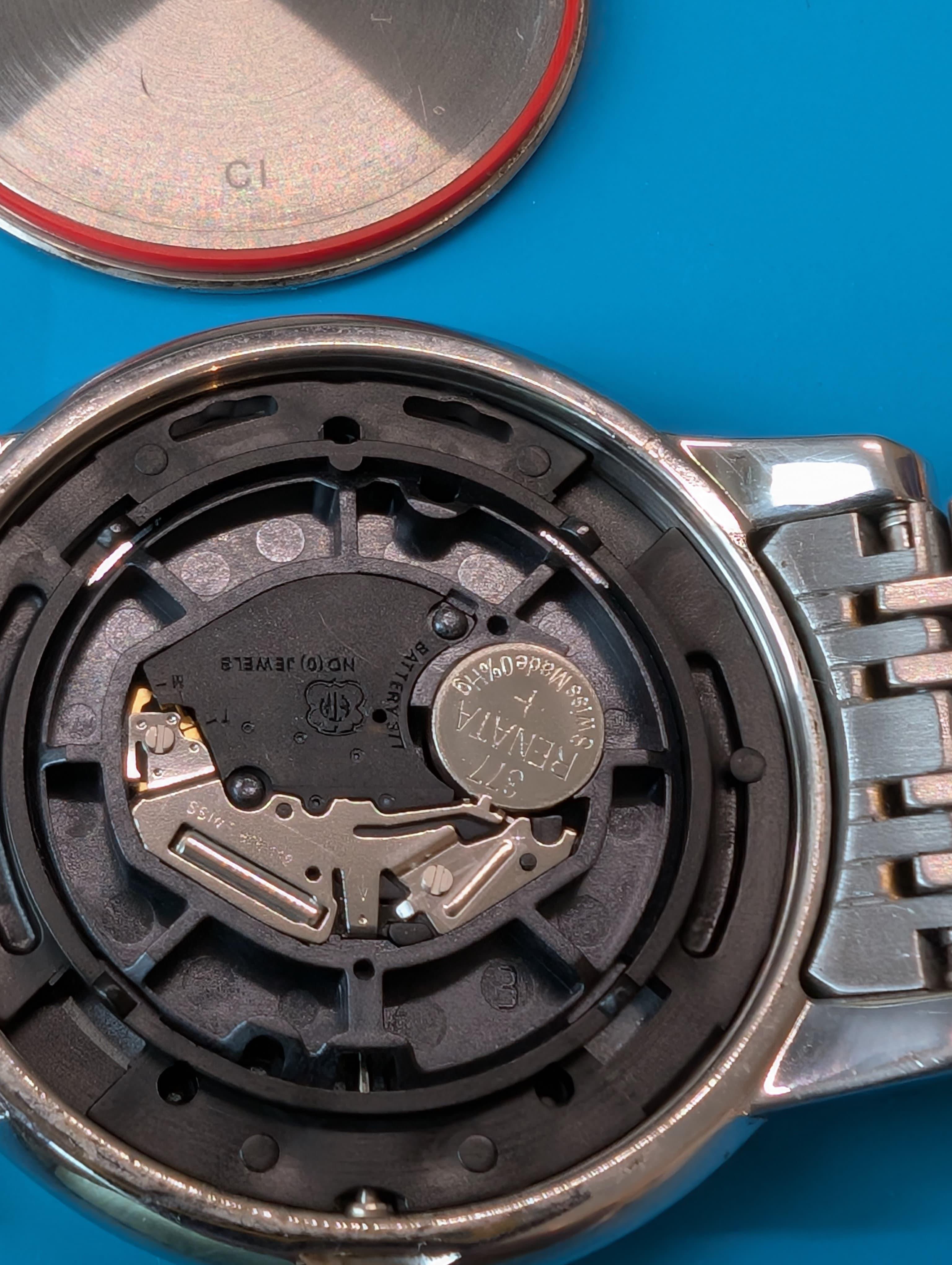

I recently acquired a used Tissot Carson that needed a new battery. The previous owner sold it to me as a broken watch and couldn't provide any information about its condition, as it had been stopped for many years.
After replacing the battery, the watch started running immediately. However, it intermittently stops for a few seconds to minutes, and sometimes when the seconds hand moves, the minutes hand shakes back and forth. I used an LR626 battery instead of the original 377 cell, as it was the only one available at the nearby store. Could this battery be causing the issue?
The movement model is not specified; it only says "ETA No (0) Jewels" as shown in the pictures. If anyone can identify the movement or provide information on compatible movements, possible solutions, or places to find parts, I would greatly appreciate it.

A few minutes after posting this, checking the pictures above, I saw in the second picture, close to the crystal, something written that I could not identify.
I opened the watch again, pulled the lupe and bingo! It was the model of the movement 805.112!

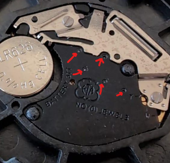

About the pivots, are they these marked in red in my picture? Which oil would you recommend here?
An update on this topic.
I took the advice from @AndyGSi above and added a drop of oil on each of the pivots a week ago. Apparently this was enough to solve the problem. Since last week it's keeping the time well without any stop.
Thanks for the suggestion. The watch is running like new.
