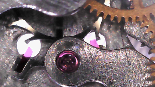

This is what the lock looks like on the pallet stones.
Entry stone looks ok to me, I think: entstonelock.png.ae8cbf766fa80dad60d770fe3e41dae6.png
(The stone has a damaged trailing edge but I don't think that's going to have much effect on anything.)
Exit stone lock looks excessive, I think: exitstonelock.png.5b0d7569fb99290b2afec1fec5b5df0f.png

Hm, the chipped entry stone might be a problem.
See, evaluation of the escapement adjustment correctness by position of tooth edge against the edge of rest surface of pallet in banking position is not correct. This depends much on correct position of banking pins, and they are easy to bend.
Wat You really need to check is if there is correct locking (the drop lock exists and is reliable) on every tooth of the wheel an on both pallet stones. When tooth moving on the chipped pallet impulse surface, it will leave it sooner as the surface is shorter. Thus the next tooth can drop not on the rest surface, but directly on impulse surface of exit pallet.  Well, when this happens, the sound is different and I didn't hear such sound in the videos, but for sure even if the locking is still present, some amplitude is lost due to the chipped pallet.

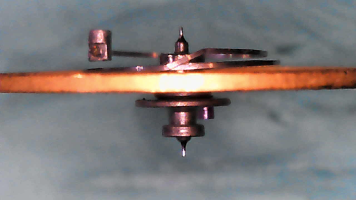

So, attending to the hairspring. I tried to tweak it a little with the balance in the movement, but didn't achieve much so I've removed the balance again and taken some pics of the side and top view of the spring on the balance.
From the side:balspring2side.png.bc5ecc816994169f21db91f1639e0c73.png
That's not perfect ... still a little conical, but otherwise pretty parallel with the balance wheel. The stud, however, does not appear to be perpendicular to the spring, and I think that's what's throwing it out when it's attached to the cock. The out of square stud is elevating one side and consequently depressing the other. Not sure how to address this ... should I loosen the pin, straighten, then tighten the pin again?
From above:balspring2top.png.e3c3d7fc58ce5ea7d40f1020bada72ac.png
Part of the overcoil doesn't look quite right to me. Where it interacts with the regulator pins should be concentric with the pivot but isn't, quite. Coming from the inside it crosses to mid-way between the third and fourth coil as it approaches the arm on the right, then its radius increases until it is outside the third coil , then comes in again and where it meets the stud it lines up with the third coil.

I think I've been looking at the wrong part of the hairspring in this movement. I've been focusing on the overcoil, including where it joins the stud, but the spring is not parallel to the balance at all, suggesting an issue with the other end. This pic shows how one side (the RHS in the pic) of the hairspring is higher than the other. The coil sits nicely in a single plane all the way in to the collet but that plane is not correctly parallel to the balance and perpendicular to the balance staff.
Next steps?
The issue seems to go all the way in to the collet itself, with the lowest point about 180º from the point where the spring joins the collet. Should I try to adjust it there (if so, I'm not sure how), or go one full turn out and give it a twist to bring the low side up, or perhaps only go half a turn out and give a twist to bring the high side down?
OK, You must twist the spring between the points marked with red circles in order to lift the lower part of the overcoil up. The part to be twisted has to be diametrical to the lowest point.
balspring3side1.png.e3bc5936f21039748074842ab6731a34.png.be47af43863f1184c9d08e8c5c935069.png
Now about the internal end. First You must observe the spring position when the balance staff is horizontal, as the stud is heavy and bends the spring. If I understand the matter of the issue correctly, You just have to lift a little the spring close to the place where it is pinned and this will get it to correct position, but first observe and try to figure if this is correct and logical as I can't see on the picture the position of the point where the spring is pinned.
Thanks, @nevenbekriev. That photo is with the balance staff horizontal: it's looking vertically down on the wheel standing on its rim on some Rodico.
Here's the pic from above I posted before with a line to show roughly where the tilt lies, with the low point below the stud. I've circled the point where I think I need to adjust, but it might be possible to go 180º before that, near the slot in the collet.
I guess the reason for this bent is the hairspring end was pressed down right in front of the collet slit. This of course happened when attempting to turn the collet with screw driver for adjusting the beat error. Of course, the spring now can be  made parallel by twisting where the red circle is, but this will position it a little higher than it used to be originally. Twisting in diametrical point will position it a little lower. Of course, this is not problem at all as such shifting is too small to make any difference. But, the most logical and correct way to bring the spring to parallel is to apply some lifting of the beginning  curve right in front of the slit, just in reverse to the way it was bent down.
