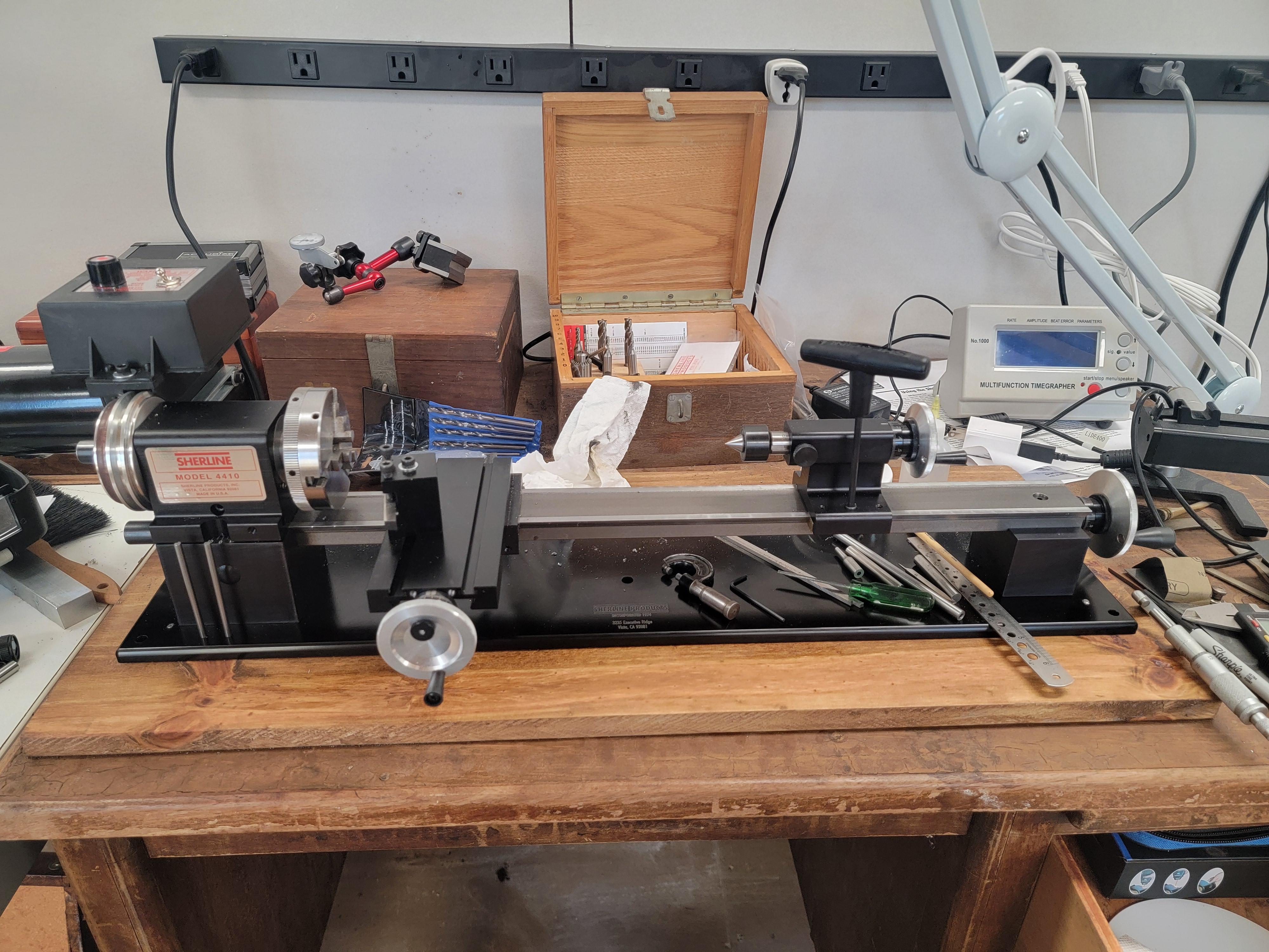

I got a new Sherline--not to replace my WW lathes--but to complement them. I wanted something that could handle bigger stock as well as have access to many inexpensive accessories.
Had to make a mental leap from hand turning to cross slide turning. So far, I am having fun.
My first project is a WW tailstock runner that supports a 1/8" carbide bit. The first attempt was a fail. I got too aggressive and removed too much material. My second attempt appears to be a success. I only needed to remove about 300 um from this 1144 steel rod. Then drill a near perfect 1/8" hole. I turned the rod between a 3-jaw chuck and a live center. I may follow up with a set screw to hold the bit.
Stay tuned for other cool projects.
Here is my Sherline setup

I have a taig, which is the cheaper version of a sherline. I also made a tailstock runner. Its best to turn it between centers to get it concentric. As far as a set screw, I would go with a different approach, as any lateral input on the drill bit will shift it slightly and move it out of center. The best option is to turn a bunch of brass sockets for all the bits you have, turn a taper on the end that will go into the tailstock runner, and shellac the drill bit in the socket. Since you already have experience making a runner, you can make another one with an internal taper that matches the external taper you put on the brass sockets.

Yes, I did turn on centers. The fit is near perfect. When removing the bit, a small vacuum is pulled and then, pop.
This was more of an experiment than addressing a need...so far
