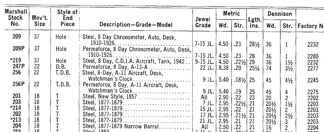

Here's another piece showing mainspring sizes.
Marshall Parts Catalogue.pdf

Yes the mainspring will be easy as there are all kinds of aftermarket including ordering a new mainspring from cousins. Ideally with any mainspring though it's best to measure the size just to make sure hundred percent of what you're getting. But typically on 18 size Waltham I don't think there a lot of slices
