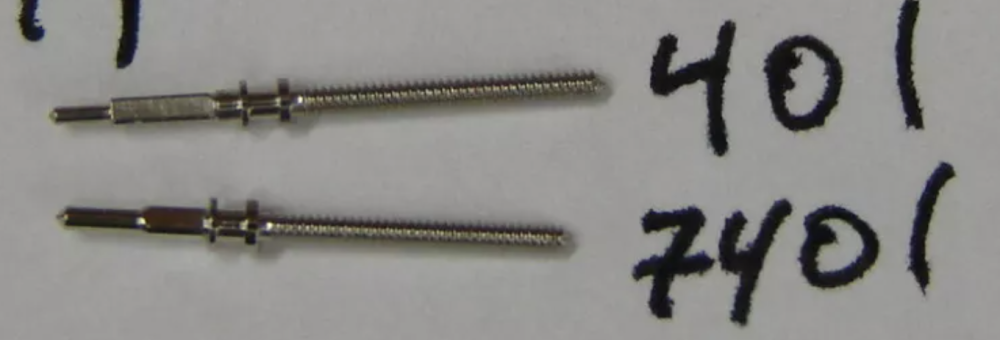

The diameter of the thread will determine the crowns that will fit the stem.
However, which crowns will fit the watch case (crown tube, if any) is a different question! You'd have to share more information/pictures and measurements for that.
Cheers
If you bought the alarm stem shown in the link, it's Tap 9 (0.9mm), as I just changed one on an AS 1931 which uses the same part.
I imagine the case will have crown tubes which you will have to measure. On my watch, a Memostar, the tubes measure 2.5mm (external diameter).  So, for example, I needed a crown Tap 9, waterproof, with 2.5mm stem tube.
Then select the desired crown diameter. I wanted 5.50mm so chose -
Do you have a pic of the case?
If you've got the winding/setting crown then you'll need to measure this to get a match or replace this also.
I'd expect the stem to be 0.9mm but you could measure the winding/setting stem thread now.

The alarm stem is tap 9, I guess the winding stem could be different ?
Edited by mikepilk
I'd have expected them to be the same to match the crowns.
The winding and alarm stems (at least on Memostar AS 1931) are both 0.90mm, but as you show, different parts.
The 1475/1568 and 1930/31 are the same movements running at different rates. So I would expect the stems to be the same.
But Cousins also list another winding stem (401) for both 1475 and 1931 movements as Tap 12. Very strange.
