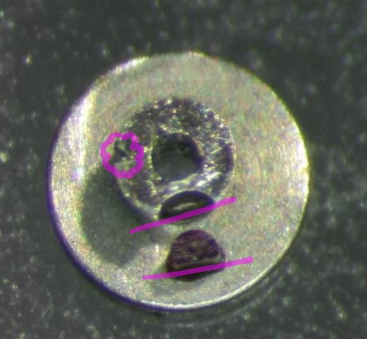

3 hours ago, praezis said:
May be too much forgiveness! How about the severe cut in the safety roller? 🤨
You mean the scratches on the top of the roller jewel?  Other side is smooth.  I could flip the jewel over.  It's loose anyways.  I was thinking of soaking the roller table in IPA to clean it and dissolve any remaining shellac and then re-shellac it.

Nah mate , Frank is telling you about the gash in the safety roller, i marked it up for you in purple.
At least thats how it appears
No. I mean the cut in the circumference of the smaller (safety-)roller - and no, not the recess at the impulse jewel position.
If the gaurd pin ( frank tells it as safety dart) if it's decided to come into play , will it catch the safety roller damage ?  Forewarned makes forearmed,  fix things before they fix you.
We need to see the roller from aside, not from above. If the cylindrical surface of the guard roller is smooth where the guard pin can touch the surface, then everything is OK. There is a video somewhere in the beginning of the thread and there no defect on the surface is seen
Well in the video the roller rotates fast so not much can be seen, but I don't imagine how such deep cut can be done, so may be it is actually not deep but just a mark and more like photo doesn't show correctly
Looks smooth to me.  The roller jewel, that is.  There is a ding to the metal.

40 minutes ago, nevenbekriev said:
This ding actually may lead to sudden stops with the balance locked by guard pin fallen in the ding. The ding can be filled with led solder and  surface smoothed.
That'd be a challenge to file, since the roller table is so small.
I didn't mean to file the ding. This will be wrong. I mean to fill it with solder, just like with car body filler, but with soldering iron and solder. Then surface of the guard roller must be restored to the correct shape and size. By file, lathe or whatever method You like. Yes, it is small, just like all parts in the watch movement. The main and most important tool in watchmaking is the file.
Yes, I understood what you meant to file.  Holding it while filing the solder will be the challenge.  I don't have a lathe (yet), but I'm sure that I can figure something out. It would seem best to attempt that without the roller jewel in place.
