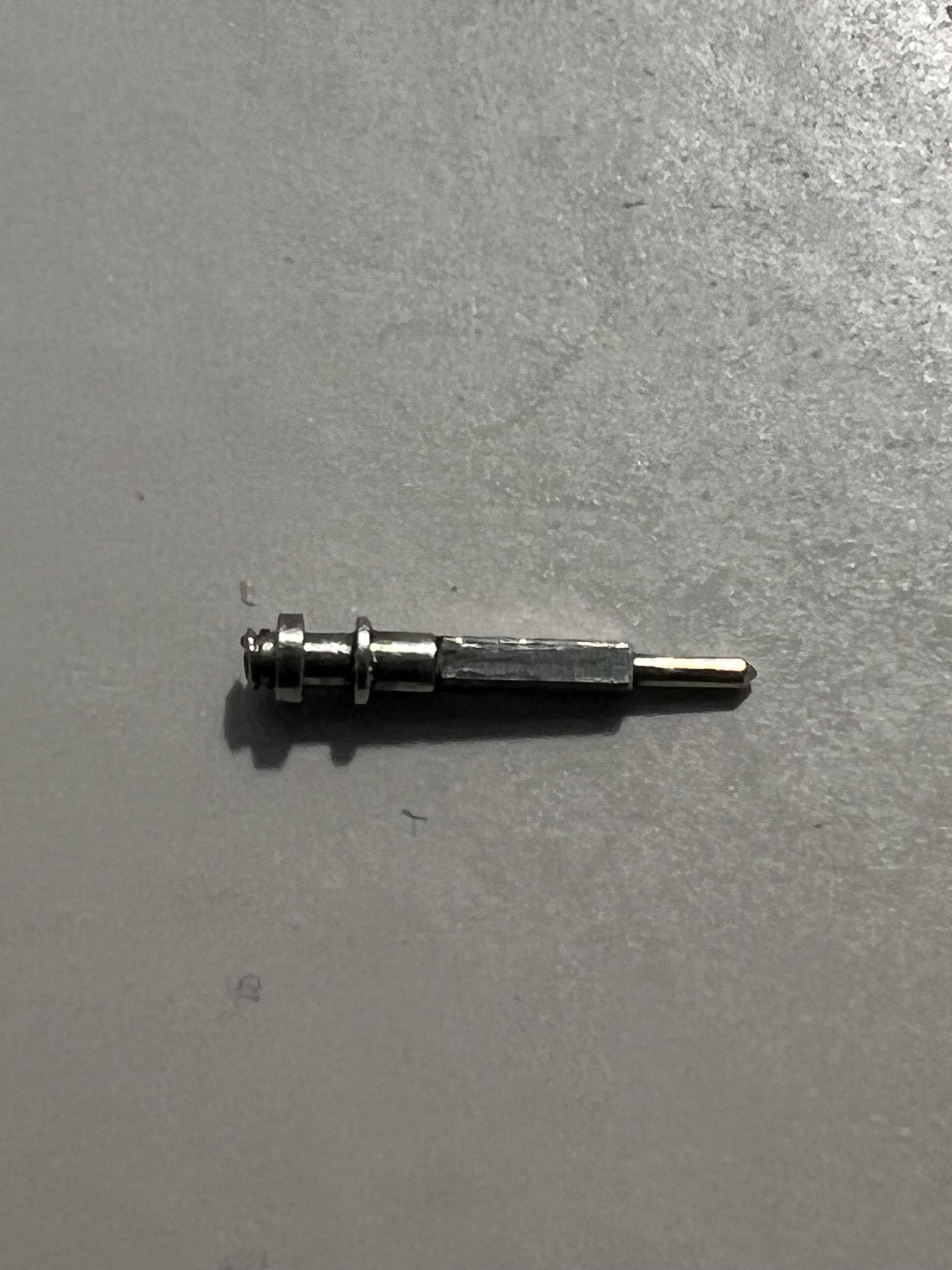

Sorry if this seems like a dumb question, but I have restored this watch and the stem broke. I’m very happy that I was able to bring it back, but sadly I’m a newbie and messed up the stem.
I’ve had trouble trying to identity the movement. I try typing stem for AS 1187/94 and I’m not sure if that is the correct way of naming the movement. You can see it in the picture near the balance. Thank you so much for any wisdom so I may continue in this beautiful world of watch service apprenticeship.

If you look for AS1187, you should be able to find it. I've done a quick search and have found several suppliers.
What would you name this one? I get confused because it has what it looks like two sets of numbers to me. Would this be a AS 1187 or AS 1194? Any wisdom on how to read these calibers would be nice. Thank you so much for your response. Cheers!
1187/94 apparantly means it's used for both the 1187 and the 1194. The difference might be one has a complication the other has not? They have the same winding stem:
Check out ranfft for more info:
The difference between the 1187 & 1194 is the size 10.5 & 11.5 so it's unusual to see both markings on the plate as this is the main difference.
It would help to know where in the world you are so people can advise a suitable supplier.

Yes this is a peculiar watch because there's a sizing difference as opposed to other things that would make a difference.

Here is a listing for what you need
Not necessary but it makes it easier to look at is you can trim off all the unnecessary stuff on eBay listing. If you find the item number and then trim off starting with the? And everything else.
https://www.ebay.com.au/itm/335453307421

Then at the link below is a nice source of looking up cross references for parts etc. and as sometimes as common with watches like this lots of variations of the stem. Including oversize ones for the plates that may be worn out. Then looks like your stems discontinued which is really an issue because they're recommending the best fit part number which does appear to be in stock.
http://cgi.julesborel.com/cgi-bin/matcgi2?ref=AS_1187
http://www.julesborel.com/s.nl/it.A/id.23640/.f

The thing that seems to have been overlooked here is what Tap size is actually required?
Not entirely is why when I snipped out the image I included all the variations. Then usually tap 10 is the standard but there are a lot of variations with this particular watch.

It's just your wording that seems to point the OP in the direction of the Tap 10.

From an economics/production perspective it makes sense to do this. You'd just have to make one design and one set of tooling to get two different sized movements. You only make the large size and perform one simple turning operation to get the smaller one. Neat! Haven't seen that before.
