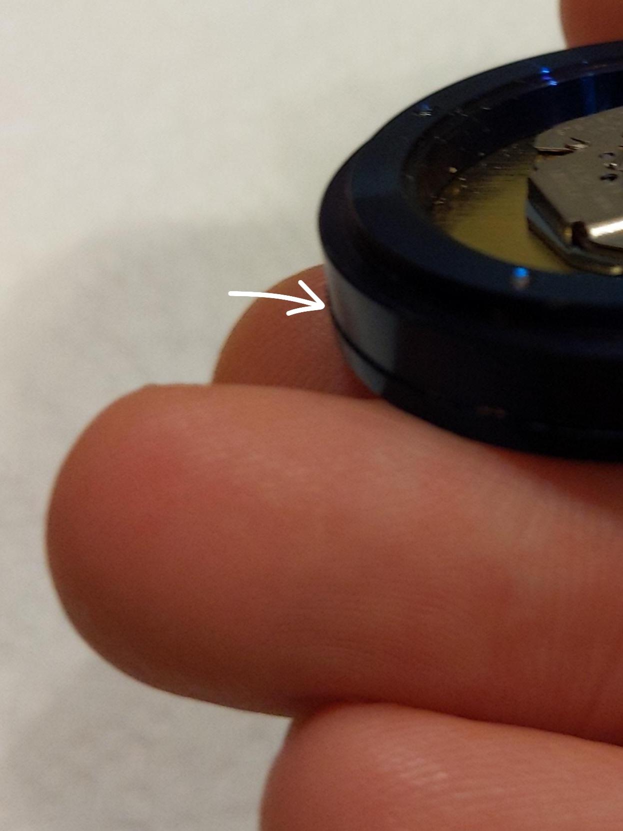

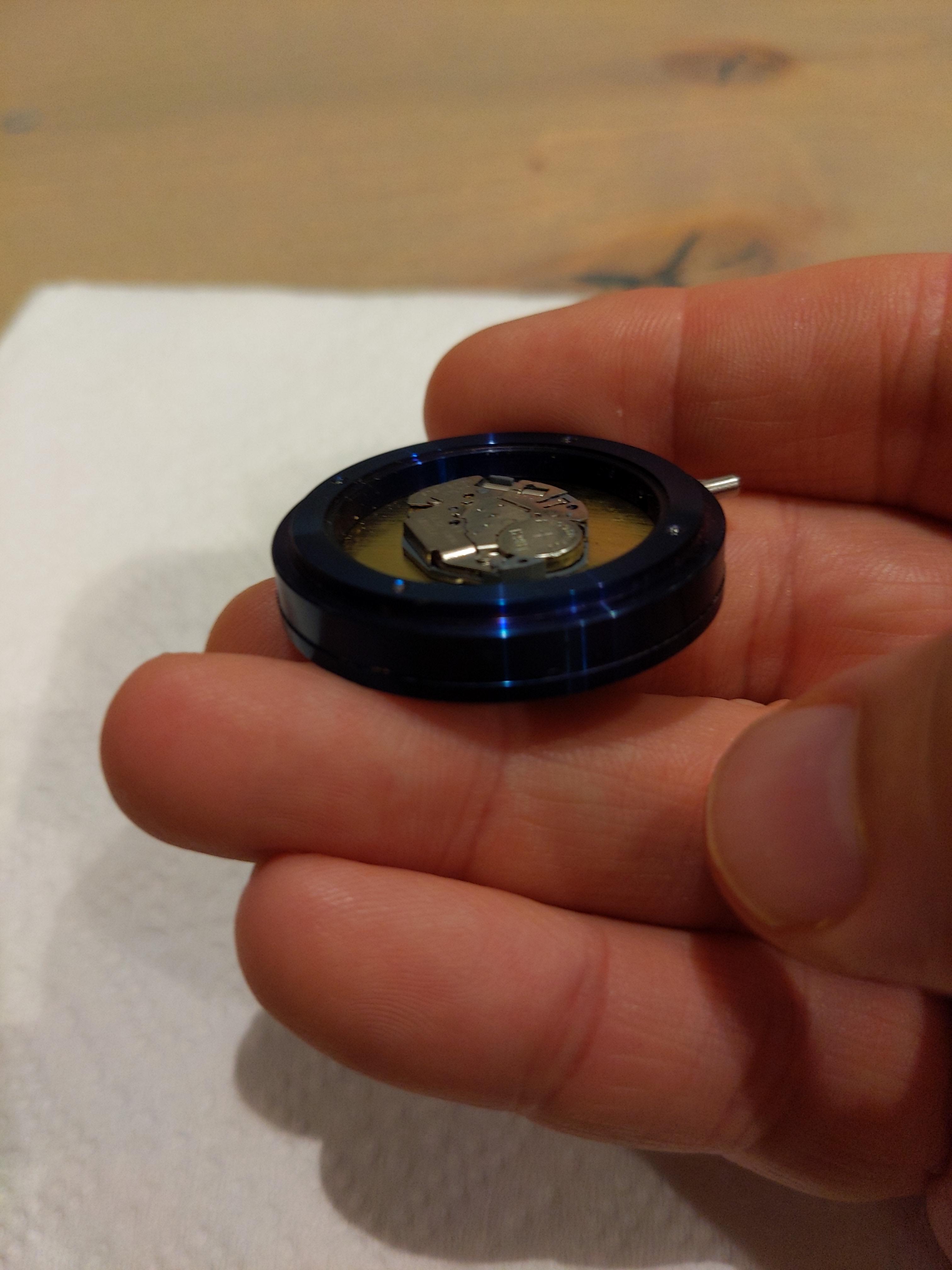

Hey, I have a Holzkern wooden watch, and it is losing some of the numbers off the dial. I opened the case...but it has an inner case that connects the movement, dial, and crystal. How do I get this thing open?! The blue metal all seems to be one piece...but obviously someone put it together in the first place. I took it to a jeweler who had no clue. Thanks in advance!

Air pressure will blast off the case back if it is not a screwed on type.
I would try using a strong double sided sticky tape on the crystal (or even super glue). A new crystal is cheap if it happens to break.
