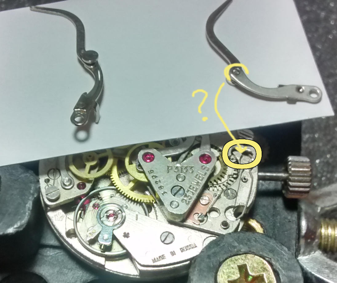

Lay out the minute wheel bridge jumper , the yoke and the setting lever. So we can get a good look at them . I have flume and the swiss parts catalogs. -
The part is roughed out with a speed run diamond disk. Finish both the ends first that way the spring doesn't get any stress and then go ahead and bring the jumper down to size last. Slowly cutting my time down. This one will be 3 hours when its finished, two hours is very doable with some practice from start to finish inc. a little polishing up on the main contact points. -
