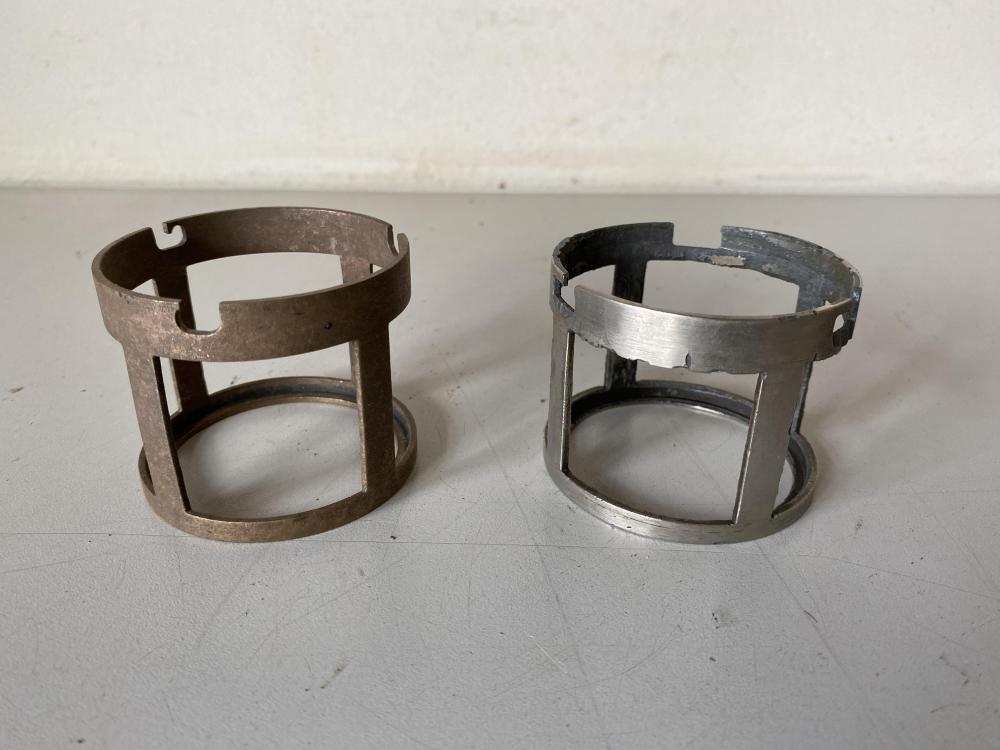

I see. I understand, thank you. Though, I have access to 3D printing and the machine shop at my univeristy. Getting those parts should be fine. An example with the National. I can request the machine shop to turn the national spindle to support an Elma basket. I think its further possible for them to make an extension to support an Elma basket for the Brenray. I am just not sure which machine requires the most effort. I am trying to see the costs of restoration on each of them and then ultimately buy the one. I haven't seen a watch cleaning machine on the local market for years. A local watch part shop which sells the Janta/Pearl watch cleaning machines for $540, a clone of the Elma Super Elite, is willing to order in from India, watch baskets, and such spares.  So I am not sure if I should let go of this opportunity. I am willing to rewire everything and update it to current safety standards.
Edited by Pap3r

Those pearl baskets are bloody awful out of the box.  i bought one six months ago to fit into my homemade machine. I spent well over an hour trying to fix the wobble between the basket and the holder, i got most of it out. The insert tray seperators are also not welded to the bottom so flat watch parts slide around into different sections of the tray and the top retention spring isn't great i also had to modify that to fit better. I paid about £70 , it wasn't exactly money wasted but i was disappointed with the quality but then they are a third of the price of Elma baskets so 🤷‍♂️
I see. The pearl machine at the supplier's showroom, looked secure? Maybe Pearl/Janta has different product grades for their complete machine and then the spares. Got pictures of your modifications? £70 is like R1600, so if I buy the red Brenray for R1500 which is £65. So I am spending just get a machine £135 or R3100 to just get the machine w/o upgrading the wiring and changing out the electronics to modern ones, like a modern speed controller compared to the old rheostats typically in these machines. So lets say, I spend another R1500 to get like paint, the wiring and electronics. Mechenical department should have loose off cuts of aluminum rod that I could kindly request to be lathed into an extender to support the pearl baskets. So R4600/£200 or R5000/£220 max. So basically half price of a new machine. It's honestly really preferred to get a machine with the baskets. But with how rare they come by, I am not sure if this opportunity is worth taking? It's definitely going to be a long term project.
I imagine a machine in the supplier's showroom, they need to have running perfect.  Both HectorLooi and I had the same problems with the wobble which was excessive to begin with and the gaps under the seperatators. I also need to place a shim between the holder and the basket to further correct the wobble which could not be completed with just filing the basket tab notches.
It runs ok now but i wasn't impressed with the quality standard but like i said it was a third of the price.
