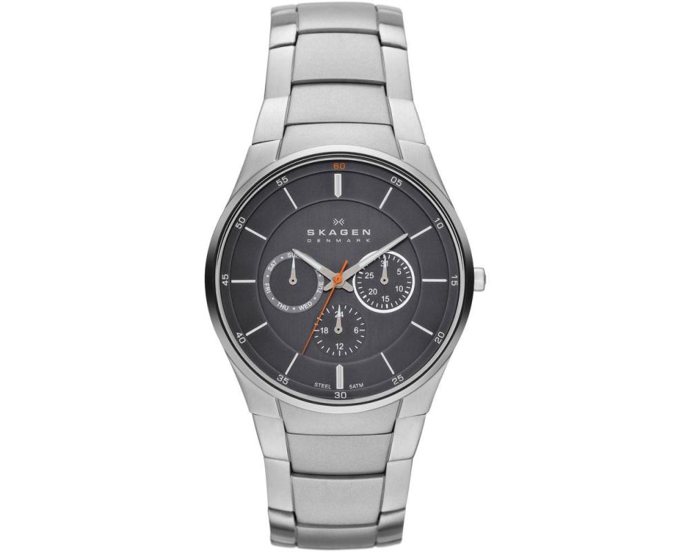

I recently smashed the crystal on my watch. It's a Skagen SKW6054, which has a domed crystal. (I've attached some images found online. I could photograph my watch, but the pieces of the crystal are in the bin!)

Cousins have domed crystals in any diameter and multiple thicknesses. The gasket is still in my watch, and with a vernier, if I push a bit, I measure the inside diameter as 36.0mm.
So, knowing nothing, that seems like it would be a reasonable interference fit, but is there a better way to figure this out? And how best to determine the correct thickness to use?
Is it OK to re-use the gasket, or should I buy a new one?

Thanks for that. I've done some measuring. Inside of the case came up at 36.7mm diameter. Gasket is L-profile 1.7mm tall, 0.4mm thick.
So I'm planning to get 1 or 2 of these gaskets, in 36.5mm
https://www.cousinsuk.com/product/lring-height-170mm-sternkreuz
And 1 or 2 crystals, in 36.0mm. The old one was definitely double domed, and the gaskets suggest 2.0mm thickness, though they are referring to flat crystals.
I'm not sure, though, whether I need a straight-walled crystal or whatever the not-straight-walled ones are called (See attached images)
Anybody know? Is it determined by the case / gasket, or will either work?
