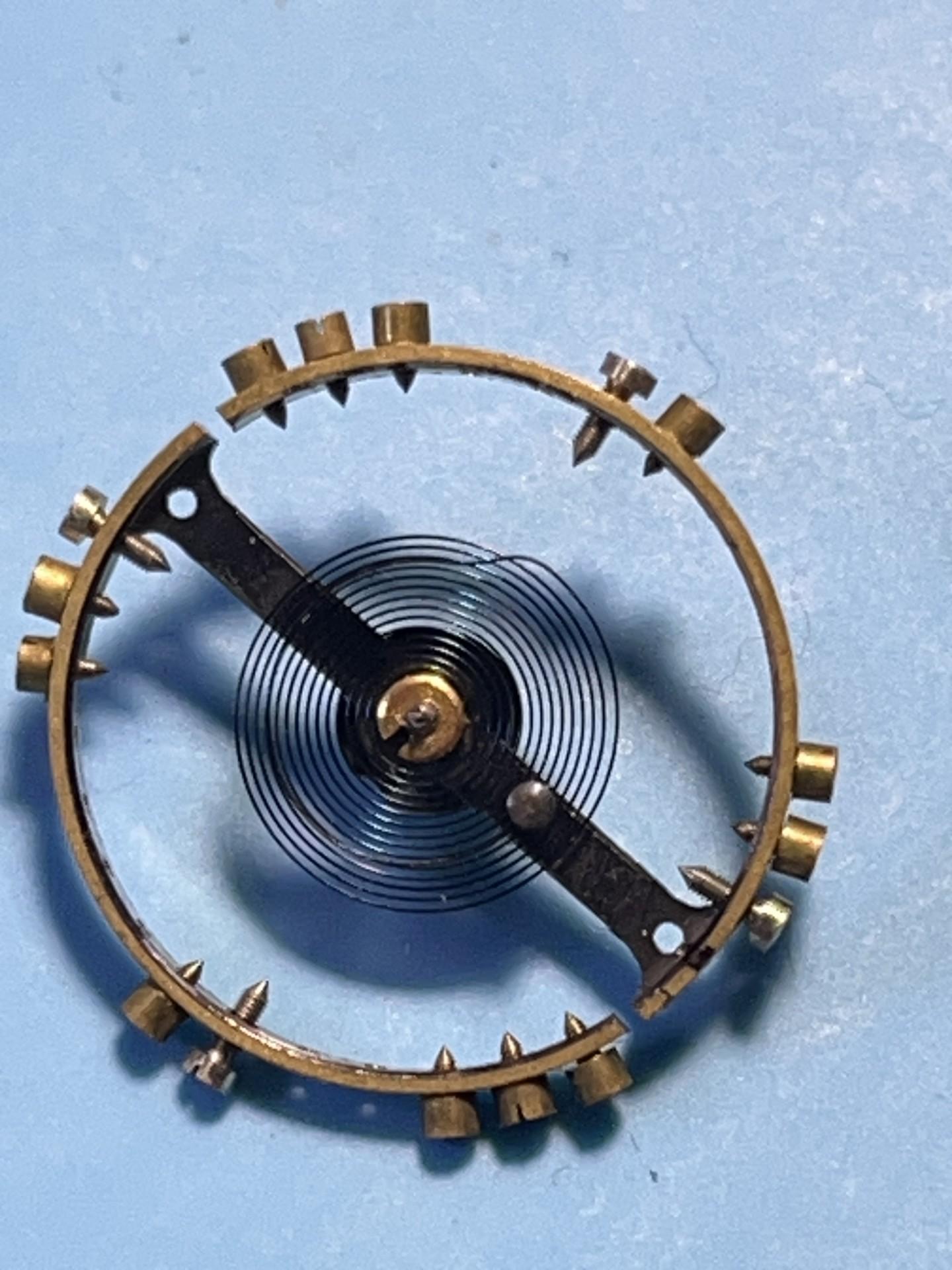

Facts: I'm working on a Hamilton 16s Grade 974 PW.  Serial 2418945.  Before doing a coa, the watch ran well in the dial down position.  In dial up it would fairly quickly stop.  There was a lot of gunk on the upper pivot and I figured that was the problem.  After the coa, it continues to do the same.  I went through troubleshooting using another thread on this topic.  The only two issues I could find are 1) the spacing of the hairspring coils are closer together (but not touching) on one side than on the other side (I don't have a pic of that).  but when I took the hairspring stud off the balance cock the coils are equally spaced all around.  2) The upper jewel (the one that sits in the balance cock) has a slight indentation where the balance staff pivots has worn it away.
Other than that, the balance isn't touching anything, the hairspring lies flat, there is plenty end shake, and the pivots look good to me.
Questions:
1) Will such a small divot in the cap jewel cause the balance to stop.  I have no idea what the measurement of the divot would be.
2) Does the last loop on the hairspring look normal.
3) Why would the balance spring bunch up on one side, but be normal once removed from the cock.
4) Would the hairspring bunching up to one side cause the balance to stop.
Thanks for any guidance you can provide.

1. I would say no. At worst it could lower the amplitude some.
2. It does from the top, but from the side it looks all wrong. It looks to me like it would foul the rest of the hairspring and cause it to stop oscillating. The Breguet overcoil should sit roughly parallel to the rest of the coils but on a higher plane. Yours looks bent in the opposite direction.
3. If the balance spring is bent near the stud it could push the whole spring off-center once the balance staff is in its jewels.
4. Unless it was very severe, then no.

Thanks for the replies guys.  In the process of following the advice above I think I discovered the problem which turned out to be operator error.  When I initially cleaned and reinstalled the cock capstone I pushed it as hard as I could and wondered why it wasn't flush.  I used a larger push rod (from my staking set) this time and got the jewel to sit flush.  Then after re-assembling the balance complete and installing it into the movement, it now continues to run dial up.  So having that capstone not touching the hole jewel fouled things up; maybe as was mentioned above the pivot shoulder was rubbing against the hole jewel.  The hairspring continues to not have equally spaced coils.  I have not timed the watch yet, but at least it is running in all positions.  I'm terrible at diagnosing watch repair problems (but if I know the problem, I can usually fix it) so this feels like a victory 🙂 .  It's the same as when I work on cars.  It's diagnosing the problem, not fixing it, that is my nemesis.  Wishing everyone well.
