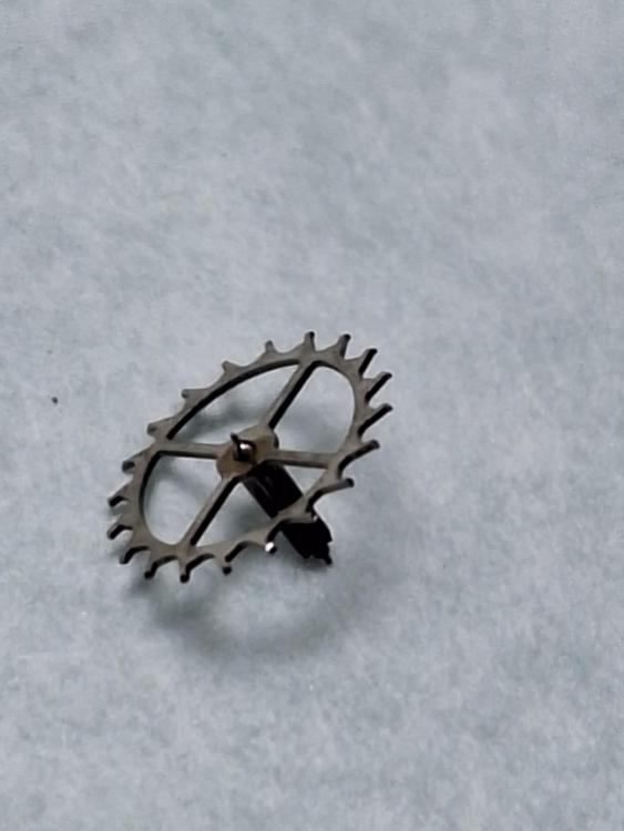

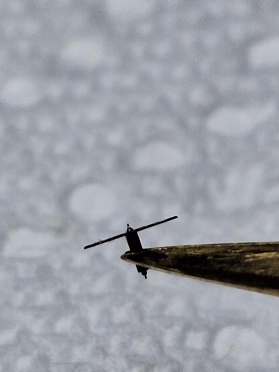

By the way, the stone will break only for a reason, and  there is no much reasons but one, so check if the pivots of the weel are intact.
Hell0 @nevenbekriev. Thank you for your advice. I have removed the old setting using my staking set--I will keep the KIF spring, since it is still good.  I am awaiting the replacement setting, and will update when I do that. In the mean time, I looked at the escape wheel and it looks ok. What do you think?
