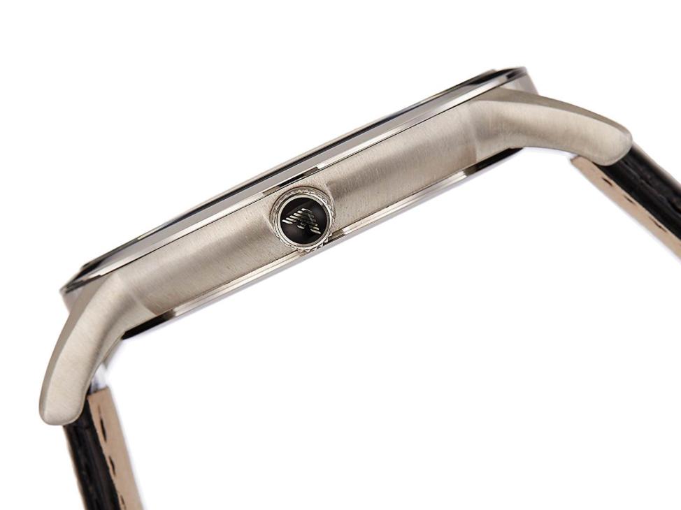

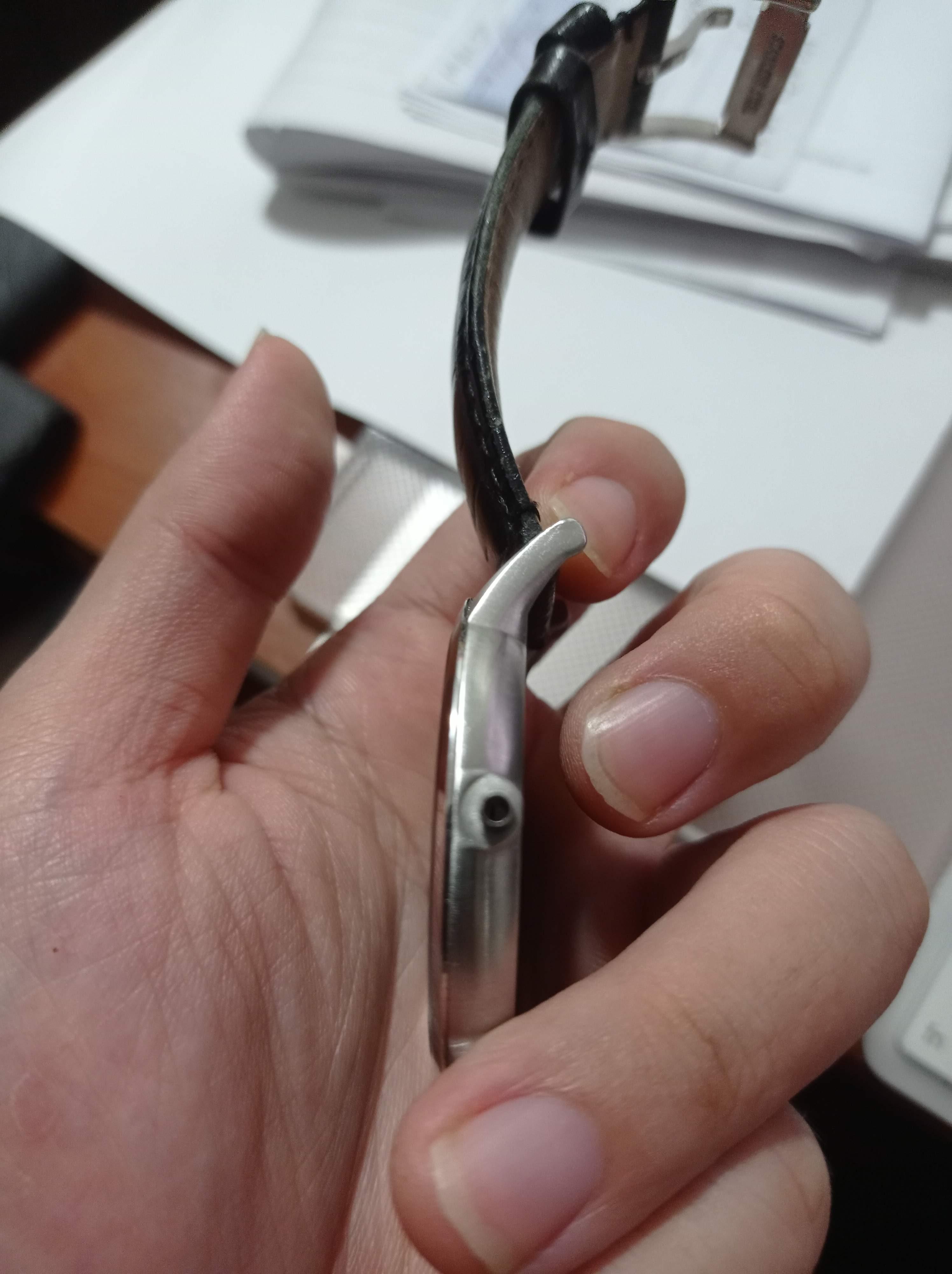

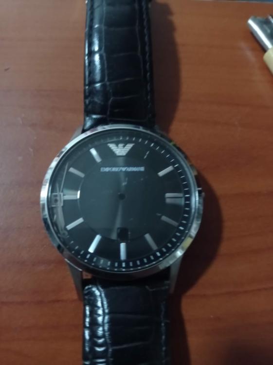

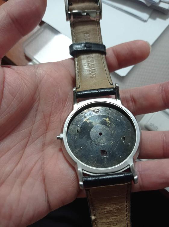

Good day. I am looking to remove the watch glass so that I can retrieve the dial and fixed in a new quartz internal movement. I can't seem to remove the glass and it can only be removed from the front.
I tried using an air pump(bicycle wheel pump) to remove the glass. The back cover pop out instead. I did a couple of trial and error and the back cover came out each time.
There is a visible bezel on the front. I tried using a jack knife / Stanley knife over it and it don't seemed to come off.
The glass is nicely fitted in to the watch. I am unsure if the crystal lift would help as crystal crawls is unable to hold on to the glass.
Any advice on how to remove the glass ? Does someone has a previous experience handling this watch ?

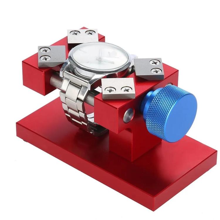

Perhaps anyone looking at changing this watch glass might consider:
1) using the watch press to break and replace with a new glass (cost is affordable).
2) using the sharp blade and hammer on the bezel
3) using the bezel removing tool as suggested by Hector above.
