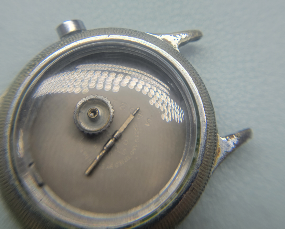

Does anyone have ideas for the best way to remove a screwed on bezel on this Elgin A-11.  I was finally able to remove the back by seeping PB blaster into the seem and gluing a nut to the back and using a wrench to unscrew it.  The bezel is proving more difficult, even after the PB blaster, because the domed glass is in the way.  Before doing anything i'm going to remove the crown and stem so as to avoid damage.  I saw a YT trick where they used a metal lid glued to the bezel but i can't find a lid the right size.  Any other thoughts?  Thank you. Arron.

Use the hot glue and jelly jar lid trick but find a deep well socket that fits just right. In the USA there are hardware stores what sell economical quality single sockets…

What am I looking at between the fluted bezel and the crystal? Is that a retaining ring for the movement or a tension ring with the crystal? Is it broken?
...or is it a reflection?
Thanks guys, that's all helpful.  Yes there is some sort of ring inside; i'm not sure the purpose, but it does appear to be broken.
i did try gluing a plastic lid to the bezel.  the glue stuck to the bezel but not the plastic, so i'm in the process of trying to find a socket as mentioned.
I would love to keep the glass intact, it has character.  if it can be removed from the front, how would i do that; with one of those claw-type crystal lifters?  it doesn't seem like the crystal is plastic however.

i bought a one inch socket today at the local hardware store.  i got to show off my ww2 watch to a couple of young sales associates; they seemed quite interested in the old watch.
then, without adding the glue i thought i'd try laying down some of that non-skid rubber padding on top of the bezel, under the socket.  voila, it came right off.  Thanks for the ideas.  Arron.
Glad it worked out.  The hot glue works on that principle- grip and surface area. When you’re finished it peels right off. The Horotec Maxipress case back opener has a set of dies with a rubber-like grip surface, too. Same idea…
