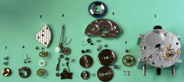

First is to line up all the big screwdrivers as these started as pocket watch calibres so, all the screws are big for me. Stripped and cleaned, the parts are these and this shows this is a simple movement.
The parts are in seven groups working from the right. This is not a blow by blow account but I took some pictures to show how it goes together. These are all the pieces.
post-1328-0-61527900-1438619504_thumb.jp
1. Plate with balance still mounted.
2. Incablocs and second wheel/cannon pinion.
3. Mainspring, barrel, ratchet wheel, crown wheel, click and barrel bridge.
4. Keyless works.
5. Train wheels and bridge.
6. Pallet fork and bridge.
7. Case clamp screws and hour wheel.
